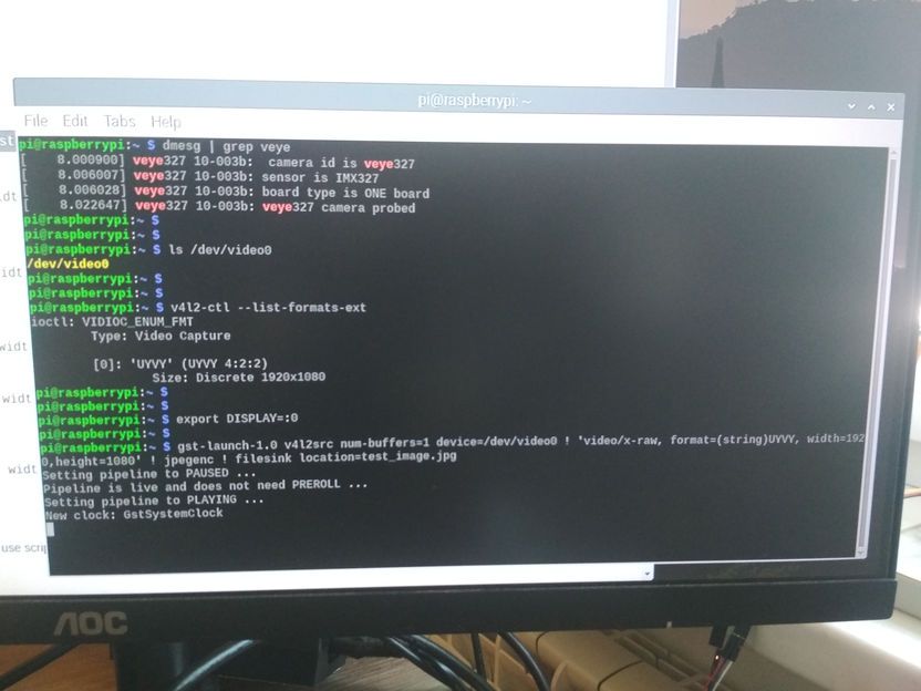

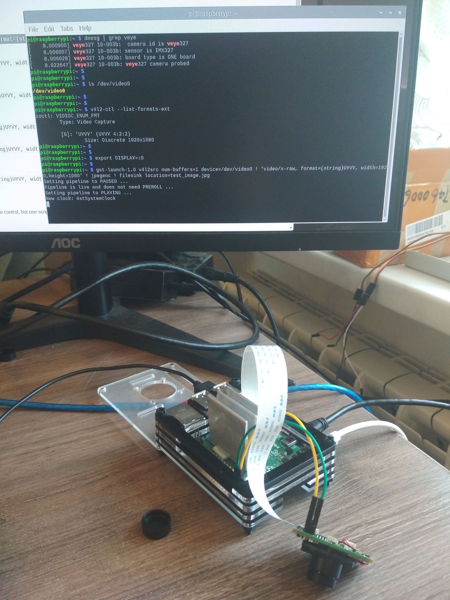

      Hello.
      The VEYE-MIPI-IMX327S camera I received works via veye_raspcam (veye_raspipreview, etc.). But I need to work through the V4L2 driver. The driver was installed according to the instructions, the camera does not work (see pictures).
      http://wiki.veye.cc/index.php/V4L2_mode_for_Raspberry_Pi
      After calling
      gst-launch-1.0 v4l2src num-buffers = 1 device = / dev / video0! 'video / x-raw, format = (string) UYVY, width = 1920, height = 1080'! jpegenc! filesink location = test_image.jpg
      the program hangs.
      VLC player also does not display image from VEYE-MIPI-IMX327S.
      When the CS-MIPI-IMX307 camera is connected to the same RPi, everything works, including through V4L2.
      Can I get a working VEYE-MIPI-IMX327S camera?

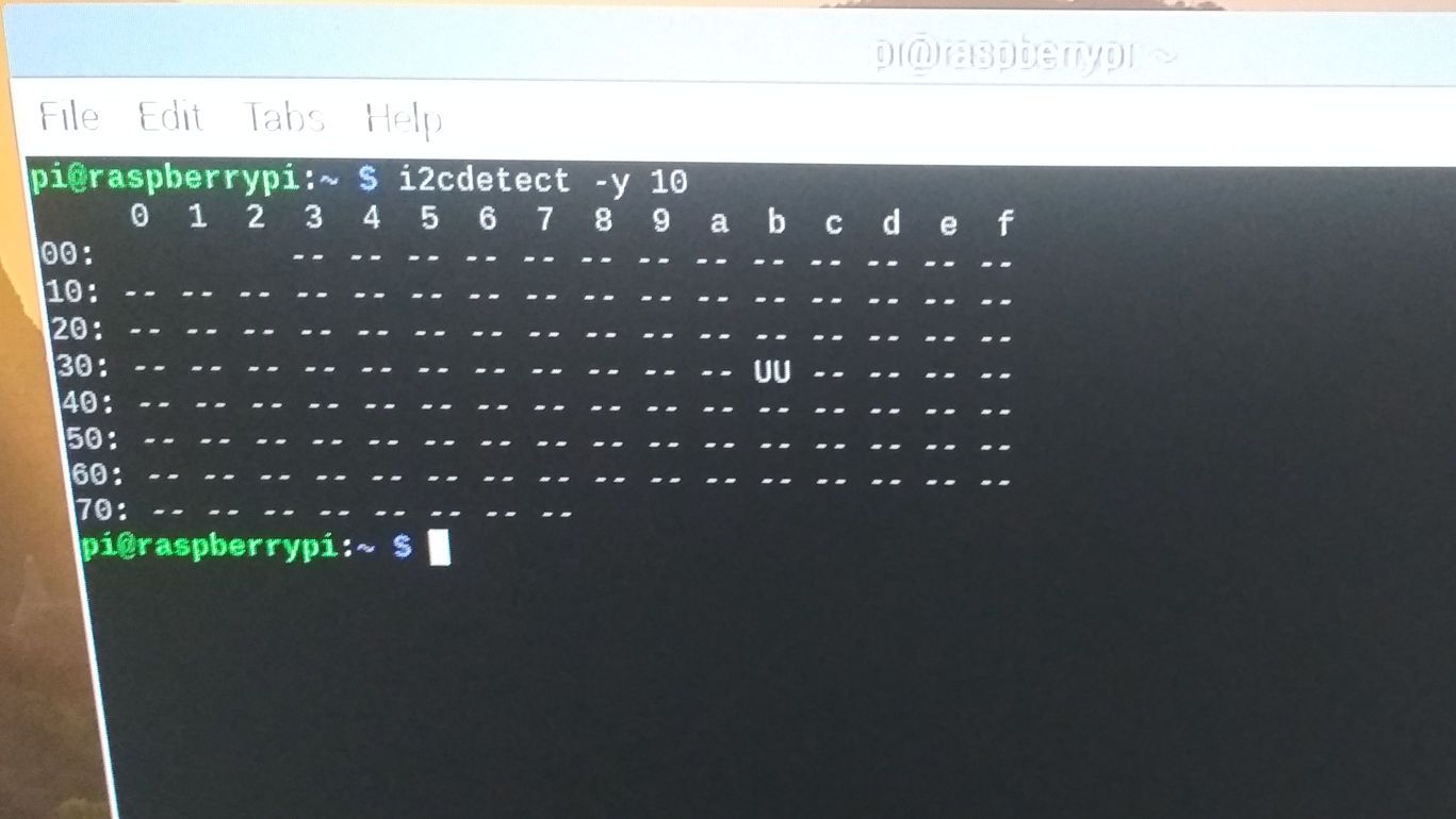

        Pls do some test for me.
        After power on rpi,please run this :
        i2cdetect -y 10
        I want to confirm if this camera is still poweron.
          Dan_LionKing @veye_xumm last edited by

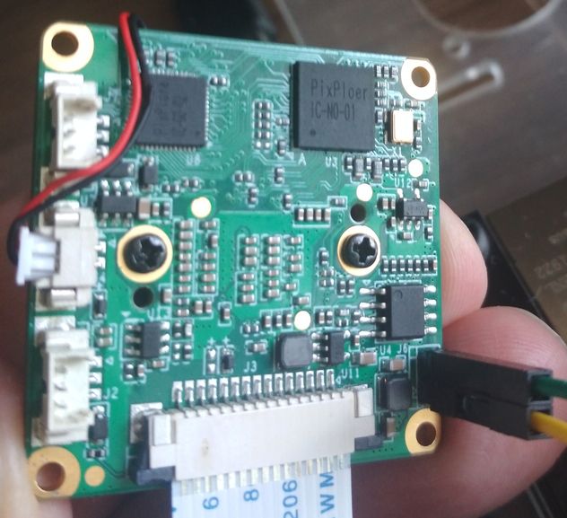

            It's a little strange because the CS-MIPI-IMX307 on your board is normal. Please confirm two points:
            1. The code you are using is the latest version of github.
            2. Make sure there are no devices in the red circle in the picture below.
              @veye_xumm said in VEYE-MIPI-IMX327S via V4L2:

                        The earliest small amount of VEYE-MIPI-IMX327S has a small different with VEYE-MIPI-327E, It has a valid reset pin. So the driver is required to control the state of the pin. And I also implemented it in the new version of the driver.
                        I soon realized that this was not compatible with the older version of the driver, so we removed the diodes that were told you in post earlier to maintain compatibility.
                        Here are my suggestions, any one of which can achieve the goal of solving the problem:
                        1. If it is convenient for you, you can remove the diode I pointed out to you in the previous post.
                        2. Update your kernel, to use the 5.10.17 Murray v7l+ version of the driver.
                        3. Based on the source code of the veye327 driver, recompile the driver for your current version of kernel.

                          Should I remove the diode?
                            veye_xumm @Dan_LionKing last edited by
                            @dan_lionking
                            It seems that I was wrong, but I suggest you try the above advice.
                              The diode was removed, the same thing.

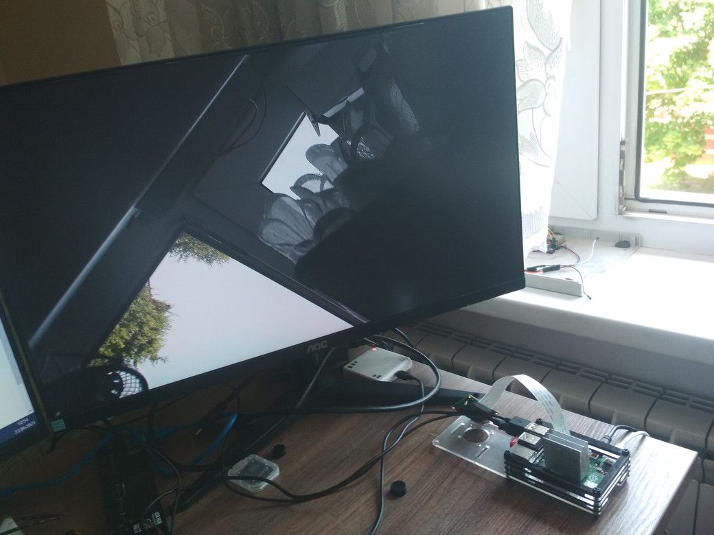

                                          @veye_xumm pi@raspberrypi:~/raspberrypi/i2c_cmd/bin $ ./veye_mipi_i2c.sh -r -f hdver
                                          hardware version is 0x 5
                                          work via V4L2
