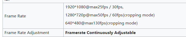

            CS-MIPI-IMX307 support 3 video formats:
            Please check the datasheet:
            http://wiki.veye.cc/index.php/CS-MIPI-IMX307_STARVIS_Module
            G 1 Reply Last reply Reply Quote 0

              g-towboat @veye_xumm last edited by
              @veye_xumm ok i am understand, just these three formats
              thank you
