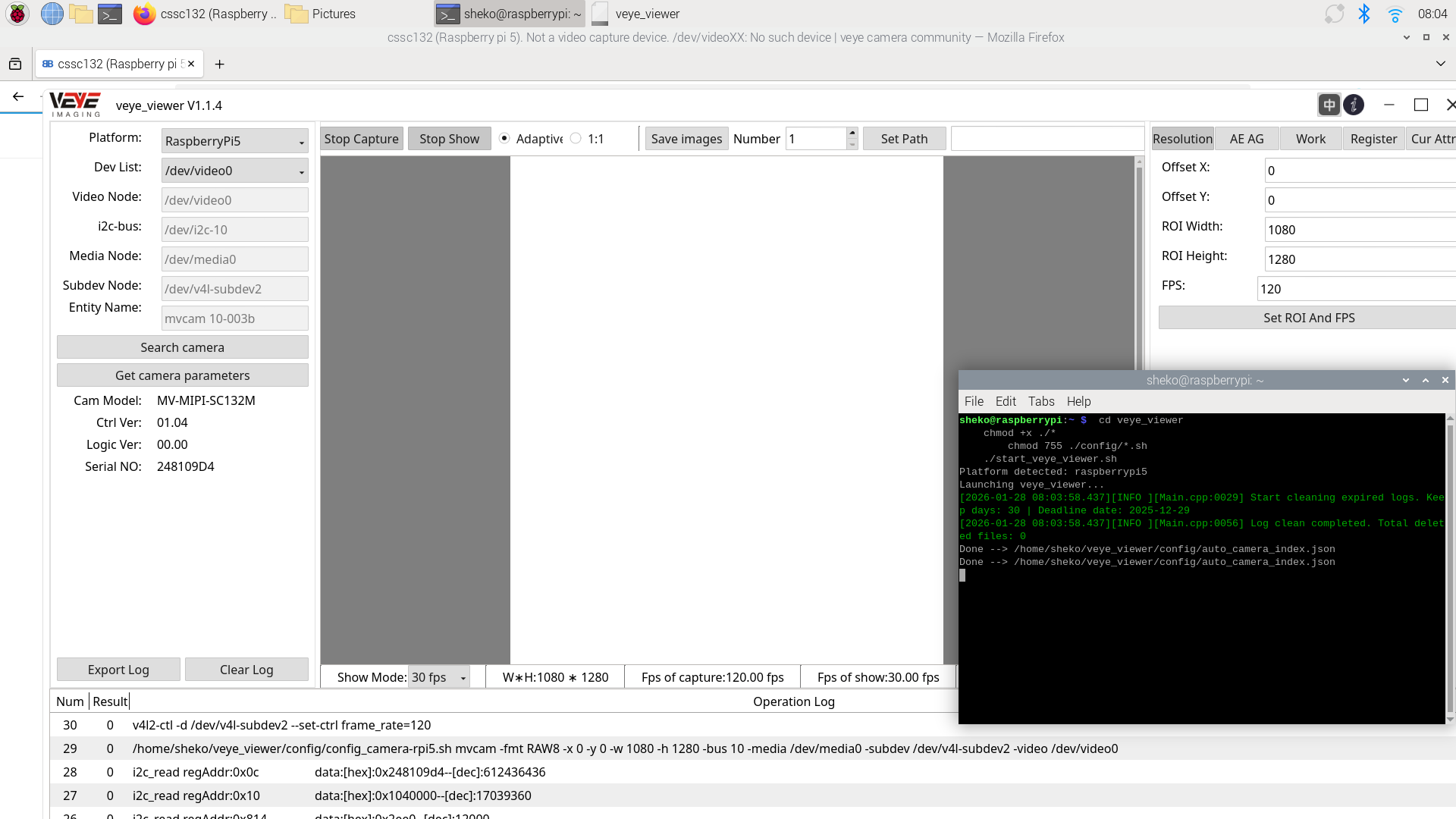

      Hello. I'm having trouble getting my RAW-MIPI-SC132M camera to work. The driver installed without errors. What am I doing wrong?
      sheko@raspberrypi:~ $ uname -r
      6.12.47+rpt-rpi-2712
      sheko@raspberrypi:~ $ v4l2-ctl --list-formats-ext
      Cannot open device /dev/video0, exiting.
      sheko@raspberrypi:~ $ camera id is cs-mipi-sc132
      bash: camera: command not found
      sheko@raspberrypi:~ $ dmesg | grep -i video
      [ 3.029552] videodev: Linux video capture interface: v2.00
      [ 3.127255] rpi-hevc-dec 1000800000.codec: Device registered as /dev/video19
      sheko@raspberrypi:~ $ sudo ffmpeg -f v4l2 -i /dev/video19 output.mp4

      [video4linux2,v4l2 @ 0x55561c74ad30] Not a video capture device.
      /dev/video19: No such device

      [ 3.091990] rp1-cfe 1f00110000.csi: found subdevice /axi/pcie@1000120000/rp1/i2c@88000/cssc132@3b
      [ 3.092673] rp1-cfe 1f00128000.csi: found subdevice /axi/pcie@1000120000/rp1/i2c@80000/cssc132@3b
      [ 3.127041] cssc132: loading out-of-tree module taints kernel.
      [ 3.127068] cssc132: disagrees about version of symbol v4l2_i2c_subdev_init
      [ 3.127070] cssc132: Unknown symbol v4l2_i2c_subdev_init (err -22)
      [ 3.127078] cssc132: disagrees about version of symbol v4l2_async_unregister_subdev
      [ 3.127079] cssc132: Unknown symbol v4l2_async_unregister_subdev (err -22)
      [ 3.127083] cssc132: disagrees about version of symbol gpiod_set_value_cansleep
      [ 3.127085] cssc132: Unknown symbol gpiod_set_value_cansleep (err -22)
      [ 3.127093] cssc132: disagrees about version of symbol v4l2_fwnode_endpoint_free
      [ 3.127094] cssc132: Unknown symbol v4l2_fwnode_endpoint_free (err -22)
      [ 3.127097] cssc132: disagrees about version of symbol fwnode_graph_get_next_endpoint
      [ 3.127099] cssc132: Unknown symbol fwnode_graph_get_next_endpoint (err -22)
      [ 3.127107] cssc132: disagrees about version of symbol i2c_transfer_buffer_flags
      [ 3.127109] cssc132: Unknown symbol i2c_transfer_buffer_flags (err -22)
      [ 3.127117] cssc132: disagrees about version of symbol v4l2_async_register_subdev_sensor
      [ 3.127119] cssc132: Unknown symbol v4l2_async_register_subdev_sensor (err -22)
      [ 3.127125] cssc132: disagrees about version of symbol regulator_bulk_disable
      [ 3.127127] cssc132: Unknown symbol regulator_bulk_disable (err -22)
      [ 3.127129] cssc132: disagrees about version of symbol i2c_register_driver
      [ 3.127130] cssc132: Unknown symbol i2c_register_driver (err -22)
      [ 3.127134] cssc132: disagrees about version of symbol __v4l2_subdev_state_get_format
      [ 3.127135] cssc132: Unknown symbol __v4l2_subdev_state_get_format (err -22)
      [ 3.127137] cssc132: disagrees about version of symbol _dev_err
      [ 3.127138] cssc132: Unknown symbol _dev_err (err -22)
      [ 3.127152] cssc132: disagrees about version of symbol regulator_bulk_enable
      [ 3.127154] cssc132: Unknown symbol regulator_bulk_enable (err -22)
      [ 3.127158] cssc132: disagrees about version of symbol devm_regulator_bulk_get
      [ 3.127159] cssc132: Unknown symbol devm_regulator_bulk_get (err -22)
      [ 3.127163] cssc132: disagrees about version of symbol v4l2_fwnode_endpoint_alloc_parse
      [ 3.127165] cssc132: Unknown symbol v4l2_fwnode_endpoint_alloc_parse (err -22)
      [ 3.127175] cssc132: disagrees about version of symbol i2c_del_driver
      [ 3.127176] cssc132: Unknown symbol i2c_del_driver (err -22)
      [ 3.127182] cssc132: disagrees about version of symbol __dev_fwnode
      [ 3.127183] cssc132: Unknown symbol __dev_fwnode (err -22)
      [ 3.158664] cssc132: disagrees about version of symbol v4l2_i2c_subdev_init
      [ 3.158677] cssc132: Unknown symbol v4l2_i2c_subdev_init (err -22)
      [ 3.158685] cssc132: disagrees about version of symbol v4l2_async_unregister_subdev
      [ 3.158687] cssc132: Unknown symbol v4l2_async_unregister_subdev (err -22)
      [ 3.158691] cssc132: disagrees about version of symbol gpiod_set_value_cansleep
      [ 3.158693] cssc132: Unknown symbol gpiod_set_value_cansleep (err -22)
      [ 3.158700] cssc132: disagrees about version of symbol v4l2_fwnode_endpoint_free
      [ 3.158701] cssc132: Unknown symbol v4l2_fwnode_endpoint_free (err -22)
      [ 3.158705] cssc132: disagrees about version of symbol fwnode_graph_get_next_endpoint
      [ 3.158706] cssc132: Unknown symbol fwnode_graph_get_next_endpoint (err -22)
      [ 3.158713] cssc132: disagrees about version of symbol i2c_transfer_buffer_flags
      [ 3.158715] cssc132: Unknown symbol i2c_transfer_buffer_flags (err -22)
      [ 3.158723] cssc132: disagrees about version of symbol v4l2_async_register_subdev_sensor
      [ 3.158724] cssc132: Unknown symbol v4l2_async_register_subdev_sensor (err -22)
      [ 3.158728] cssc132: disagrees about version of symbol regulator_bulk_disable
      [ 3.158729] cssc132: Unknown symbol regulator_bulk_disable (err -22)
      [ 3.158731] cssc132: disagrees about version of symbol i2c_register_driver
      [ 3.158733] cssc132: Unknown symbol i2c_register_driver (err -22)
      [ 3.158736] cssc132: disagrees about version of symbol __v4l2_subdev_state_get_format
      [ 3.158738] cssc132: Unknown symbol __v4l2_subdev_state_get_format (err -22)
      [ 3.158740] cssc132: disagrees about version of symbol _dev_err
      [ 3.158741] cssc132: Unknown symbol _dev_err (err -22)
      [ 3.158857] cssc132: disagrees about version of symbol regulator_bulk_enable
      [ 3.158862] cssc132: Unknown symbol regulator_bulk_enable (err -22)
      [ 3.158868] cssc132: disagrees about version of symbol devm_regulator_bulk_get
      [ 3.158869] cssc132: Unknown symbol devm_regulator_bulk_get (err -22)
      [ 3.158875] cssc132: disagrees about version of symbol v4l2_fwnode_endpoint_alloc_parse
      [ 3.158876] cssc132: Unknown symbol v4l2_fwnode_endpoint_alloc_parse (err -22)
      [ 3.158885] cssc132: disagrees about version of symbol i2c_del_driver
      [ 3.158886] cssc132: Unknown symbol i2c_del_driver (err -22)
      [ 3.158891] cssc132: disagrees about version of symbol __dev_fwnode
      [ 3.158892] cssc132: Unknown symbol __dev_fwnode (err -22)
      [ 3.191020] cssc132: disagrees about version of symbol v4l2_i2c_subdev_init
      [ 3.191026] cssc132: Unknown symbol v4l2_i2c_subdev_init (err -22)
      [ 3.191035] cssc132: disagrees about version of symbol v4l2_async_unregister_subdev
      [ 3.191036] cssc132: Unknown symbol v4l2_async_unregister_subdev (err -22)
      [ 3.191041] cssc132: disagrees about version of symbol gpiod_set_value_cansleep
      [ 3.191043] cssc132: Unknown symbol gpiod_set_value_cansleep (err -22)
      [ 3.191051] cssc132: disagrees about version of symbol v4l2_fwnode_endpoint_free
      [ 3.191052] cssc132: Unknown symbol v4l2_fwnode_endpoint_free (err -22)
      [ 3.191055] cssc132: disagrees about version of symbol fwnode_graph_get_next_endpoint
      [ 3.191057] cssc132: Unknown symbol fwnode_graph_get_next_endpoint (err -22)
      [ 3.191065] cssc132: disagrees about version of symbol i2c_transfer_buffer_flags
      [ 3.191067] cssc132: Unknown symbol i2c_transfer_buffer_flags (err -22)
      [ 3.191076] cssc132: disagrees about version of symbol v4l2_async_register_subdev_sensor
      [ 3.191077] cssc132: Unknown symbol v4l2_async_register_subdev_sensor (err -22)
      [ 3.191082] cssc132: disagrees about version of symbol regulator_bulk_disable
      [ 3.191083] cssc132: Unknown symbol regulator_bulk_disable (err -22)
      [ 3.191085] cssc132: disagrees about version of symbol i2c_register_driver
      [ 3.191086] cssc132: Unknown symbol i2c_register_driver (err -22)
      [ 3.191090] cssc132: disagrees about version of symbol __v4l2_subdev_state_get_format
      [ 3.191091] cssc132: Unknown symbol __v4l2_subdev_state_get_format (err -22)
      [ 3.191093] cssc132: disagrees about version of symbol _dev_err
      [ 3.191094] cssc132: Unknown symbol _dev_err (err -22)
      [ 3.191107] cssc132: disagrees about version of symbol regulator_bulk_enable
      [ 3.191108] cssc132: Unknown symbol regulator_bulk_enable (err -22)
      [ 3.191111] cssc132: disagrees about version of symbol devm_regulator_bulk_get
      [ 3.191112] cssc132: Unknown symbol devm_regulator_bulk_get (err -22)
      [ 3.191116] cssc132: disagrees about version of symbol v4l2_fwnode_endpoint_alloc_parse
      [ 3.191117] cssc132: Unknown symbol v4l2_fwnode_endpoint_alloc_parse (err -22)
      [ 3.191127] cssc132: disagrees about version of symbol i2c_del_driver
      [ 3.191128] cssc132: Unknown symbol i2c_del_driver (err -22)
      [ 3.191132] cssc132: disagrees about version of symbol __dev_fwnode
      [ 3.191134] cssc132: Unknown symbol __dev_fwnode (err -22)

                            Sheko last edited by
                            the program started
                            white screen - no image
                            sheko@raspberrypi:~ $ cd veye_viewer
                            chmod +x ./*
                            chmod 755 ./config/*.sh
                            ./start_veye_viewer.sh
                            Platform detected: raspberrypi5
                            Launching veye_viewer...
                            [2026-01-28 07:59:42.882][INFO ][Main.cpp:0029] Start cleaning expired logs. Keep days: 30 | Deadline date: 2025-12-29
                            [2026-01-28 07:59:42.886][INFO ][Main.cpp:0056] Log clean completed. Total deleted files: 0
                            Done --> /home/sheko/veye_viewer/config/auto_camera_index.json
                            (veye_viewer:2119): GLib-GObject-CRITICAL **: 07:59:44.547: g_object_unref: assertion 'G_IS_OBJECT (object)' failed
                            [2026-01-28 08:00:53.233][WARN ][unknown_file:----] libpng warning: iCCP: known incorrect sRGB profile
                            [2026-01-28 08:00:53.234][WARN ][unknown_file:----] libpng warning: iCCP: known incorrect sRGB profile
                            [2026-01-28 08:00:53.235][WARN ][unknown_file:----] libpng warning: iCCP: known incorrect sRGB profile
                              veye_xumm @Sheko last edited by
                              @sheko It looks like nothing is abnormal. You haven’t installed a lens, right?
