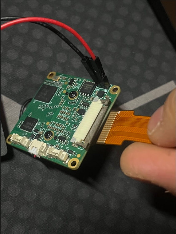

      As a sanity check, I've double/triple checked the orientation of the camera cables to my Jetson, the camera pins to the board are facing DOWN, while to the IMX462 the pins are facing UP

        1. I think your hardware connections are correct. Also, the Dupont wires are generally not required.
        2. I believe there are some issues with your operations on the .ko and .dtb files. Let me explain in detail below:
          Your camera model is VEYE-MIPI-IMX462, which is a color camera. You should only use the veyecam2m-labeled DTBO and veyecam.ko. There is no need to update the .ko files in the downstream and upstream directories.
        3. However, judging from the dmesg output, it seems that you have also performed some correct steps, because the command dmesg | grep veye shows that the driver has been loaded correctly and has attempted to probe the camera.
        Overall, I think there are some minor issues in your operations, but the general approach seems to be correct. Based on the following information:

        I can only suspect a hardware issue. Please remove the Dupont wires, or try using a different MIPI port.

              • Re-flashed my Orin with the NVIDIA SDK manager
              • Changed the CSI cable with the second cable that was provided by you guys. I also ensured the black tab on the Jetson Orin was facing 'up' while the pins on the wider end of the CSI cable that went to the IMX462 was facing 'towards' the tab (Please see pictures below for reference)
              • And below are the steps that I took that eventually lead to the same probing error that was mentioned earlier

              After restarting the Orin, I got the following dmesg output
              sudo dmesg | grep veyecam
              [   11.201520] veyecam 9-003b: probing v4l2 sensor
              [   11.201648] veyecam 9-003b: tegracam sensor driver:veyecam_v2.0.6
              [   11.211991] veyecam 9-003b: probe failed
              [   11.212000] veyecam 9-003b: board setup failed
              [   11.212329] veyecam 10-003b: probing v4l2 sensor
              [   11.212455] veyecam 10-003b: tegracam sensor driver:veyecam_v2.0.6
              [   11.227303] veyecam 10-003b: probe failed
              [   11.227310] veyecam 10-003b: board setup failed
              I did my best to be as thorough as possible, but at this point I'm not sure what else I could be missing

                I decided to return the camera sensor and look for a better alternative despite my best efforts
                  veye_xumm @D_101 last edited by
                  @d_101 Sorry for the late reply. Based on the current situation, I can only suspect a hardware issue that is causing the I2C path to be unavailable. This could be a problem with your mainboard or with the camera itself. Please return the camera to us, and we will perform testing and inspection.
