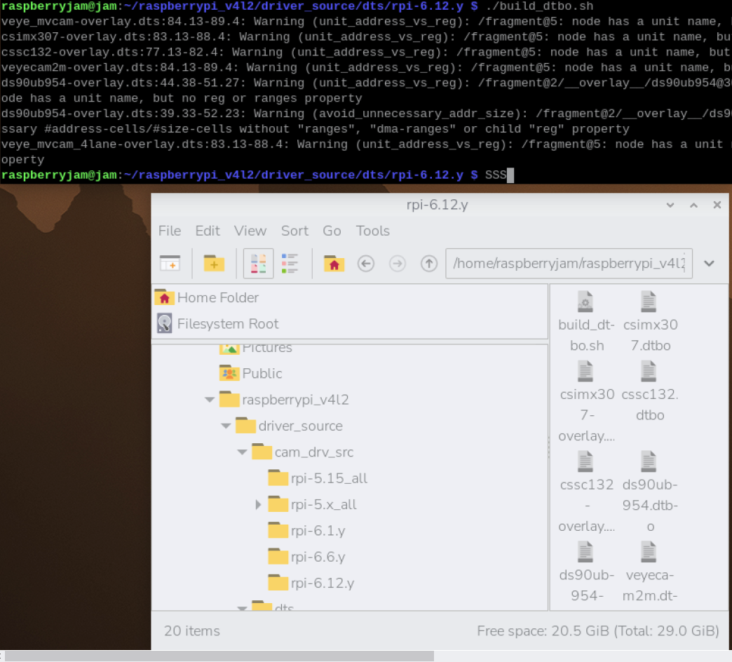

      Followed this, when compiling dtb the error pops up
      ![alt text](c07f9324-c61b-4227-80f0-d2da4621d91e-изображение.png image url)

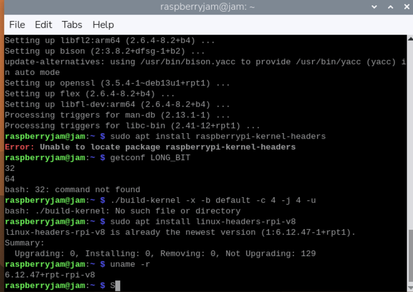

      Trying to install headers didn't work, manually copied and created the directories, still an error

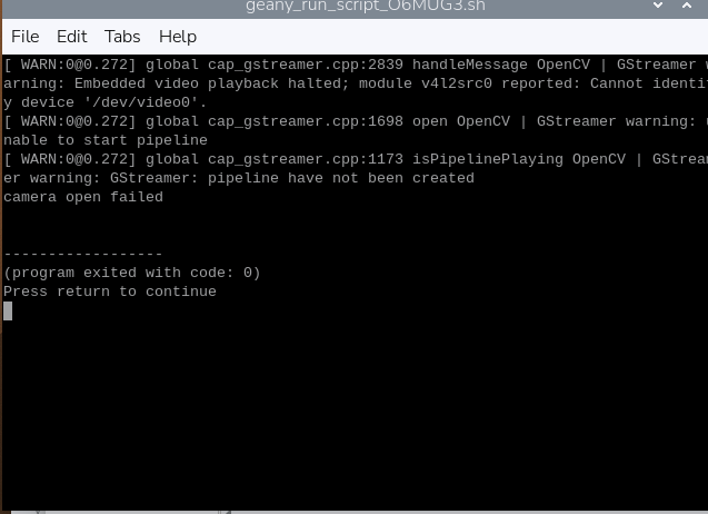

      dmesg doesn't work (doesn't say anything. Camera worked before with Legacy mode.
      ![alt text](bada1a01-c29c-4829-98d0-7bbd0cc2e727-изображение.png image url)
      do I need to recompile on ubuntu? I don't have one installed, don't have spare pc or laptop.
      I want to use it with opencv and yolov3tiny for bug detection.

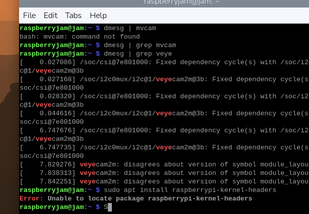

        veye_xumm @jambojettt last edited by
        @jambojettt According to the dmesg information, you have successfully installed the veyecam2m driver. However, the camera was not detected. What model of camera are you using?

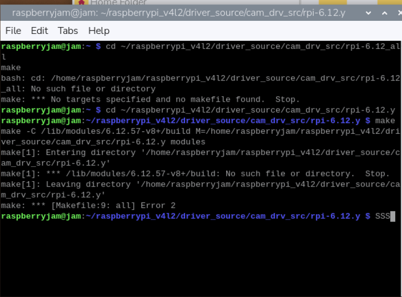

              jambojettt @veye_xumm last edited by
              @veye_xumm this didn't work, I updated the raspi-config to the latest one, this command didn't work. Tried this several times to no avail.
                jambojettt @jambojettt last edited by

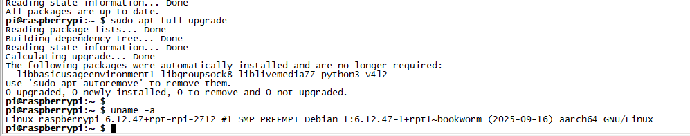

                  Sorry for the slightly delayed reply. Normally, piOS comes with kernel-headers pre-installed. For example, here is a screenshot of my current system:
                  I suspect that you might have updated to a newer minor version of piOS, which caused this issue. The current major version of piOS should be 6.12.47.
                      @veye_xumm yes, it updated to 6.12.57, but this problem also was in 6.12.47 that it was updated from.
                      How do I get the headers?

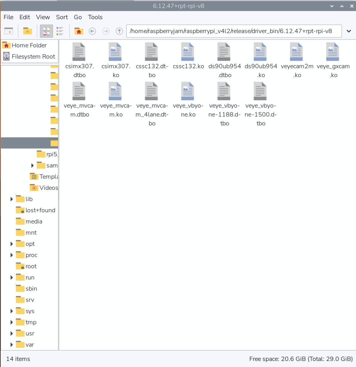

                        My Raspberry Pi comes with headers by default. You might want to reinstall piOS? We've already released the 6.12.47 ko file on GitHub.
                          @veye_xumm I tried it before. Right now reinstalled Pi OS from Pi Imager, no kernel headers, so problem not resolved.
                            @jambojettt Just checked, I have a 64 bit version, just to be sure.8df17cf4-ca53-47b8-9727-a8736dd077dc-изображение.png d9607aad-14c0-4f65-bfdc-0c86dedff947-изображение.png
                            Kernel headers are installed.

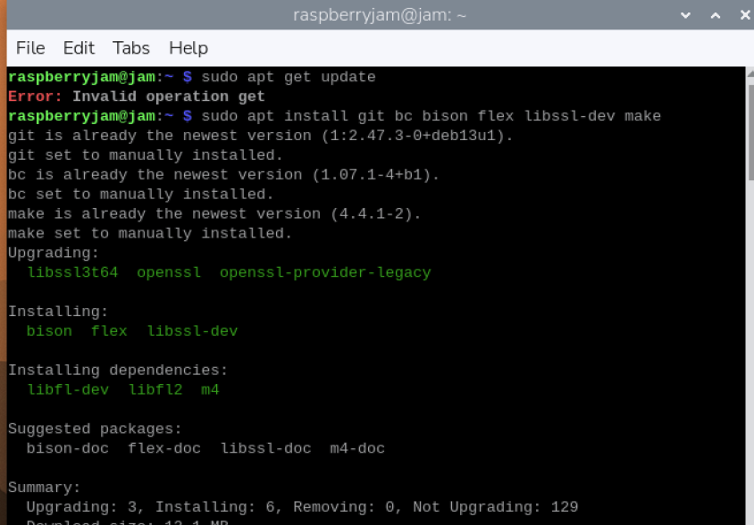

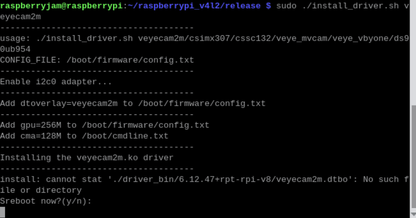

                              Did everything step by step on the github page. The kernel thing didn't work. Don't know what to do next. dmesg didn't work

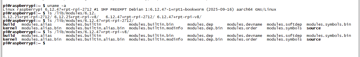

                                Can you help run this script and send me the results?
                                uname -a
                                ls /usr/lib/modules/
                                ls /usr/lib/modules/$(uname -r)
                                  Wrote them, sending the results.
                                        @jambojettt
                                        Please try this released version again. This time it will work.
                                        https://github.com/veyeimaging/raspberrypi_v4l2/releases/tag/v1.27

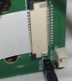

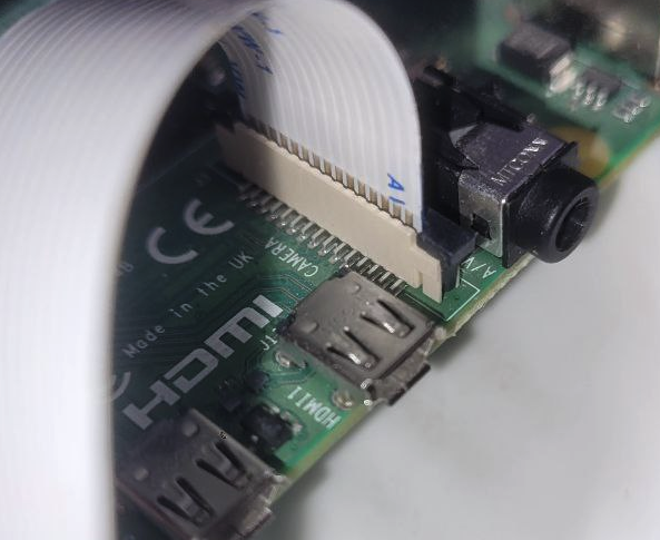

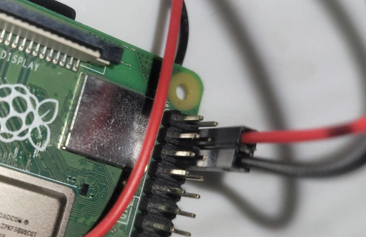

                                          @veye_xumm did delete a folder raspberrypi_v4l2, reinstalled. Checked the connections, everything was in order. Pins on the ribbon cable to the top on the module and to the front on the pi. Checked the power pins. Everything was okay. I don't have samba in raspi-config, but I enabled ssh. Also don't have Camera interface in options.
                                          The dev/video0/ is still unfound.
                                            @jambojettt
                                            show me the result of this cmd:
                                            dmesg | grep veye
