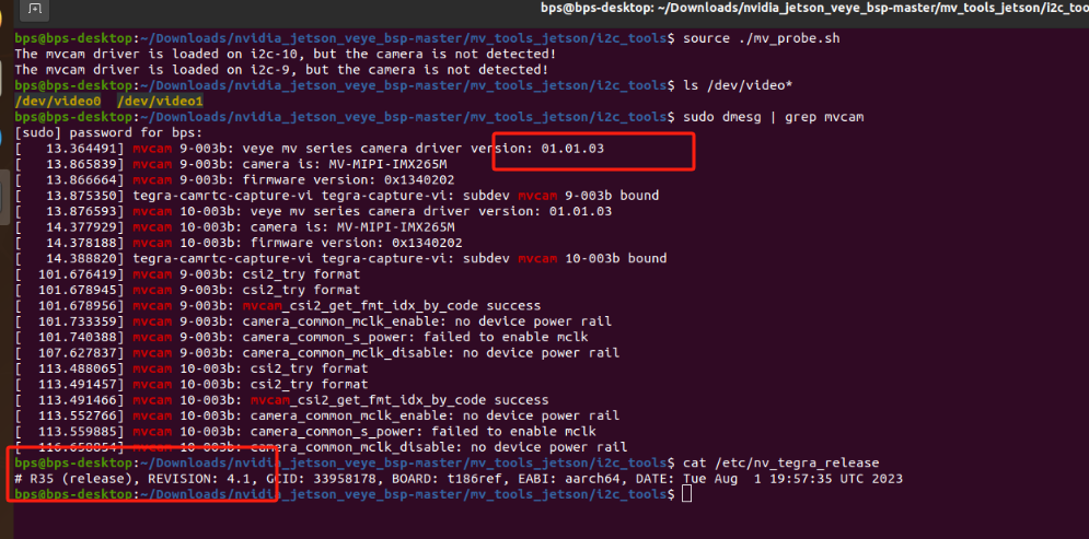

      Hello
      I installed the imx265 camera drivers on the A603 board from seeedstudio with Jetson orin nx 8gb and Jetpack 36.4.0 but it doesn't give me an image. In the image below I put the output of the dmesg:Screenshot from 2025-07-09 18-20-43.png

        It appears that the camera was successfully probed on i2c-10. Next, you can refer to Part 9 and Part 10 in this link to try capturing images.
        You can also try using veye_viewer.

          hi , i use mv_probe.sh in jetpack6.0 and i get same resault when i use jetpack5.1.2, yet i get black screan when i use this pipeline:
          gst-launch-1.0 v4l2src device=/dev/video0 ! "video/x-raw,format=(string)GRAY8, width=2048, height=1544, framerate=(fraction)55/1" ! videoconvert ! autovideosink sync=false -v

            Your current image is Jetpack 5.1.2 with L4T version r35.4.1. The mvcam driver included in it is relatively old, so the mv_probe.sh script cannot work properly. — For more details, you can refer to the comments at the top of the mv_probe.sh script.
            In addition, please try running the following script and see if it shows continuous messages indicating that data is being received. If it still fails to receive data, please run sudo dmesg to check whether there are any error messages.
            export WIDTH=2560
            export HEIGHT=1544
            export FPS=50
            v4l2-ctl --set-ctrl roi_x=0
            v4l2-ctl --set-ctrl roi_y=0
            v4l2-ctl --set-fmt-video=width=$WIDTH,height=$HEIGHT,pixelformat=GREY
            v4l2-ctl --set-ctrl frame_rate=$FPS
            v4l2-ctl --set-fmt-video=width=$WIDTH,height=$HEIGHT,pixelformat=GREY --stream-mmap --stream-count=-1 --stream-to=/dev/null
