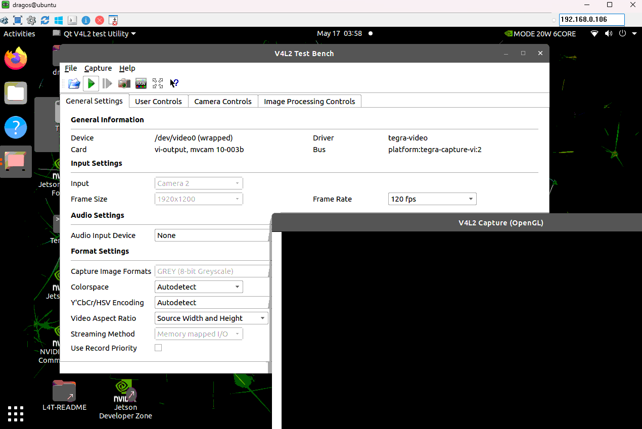

      After opening qv4l2:

        dragos @dragos last edited by dragos
        Here are the dmesg logs from the 2-lane mode and 2-lane DTB, with the camera running in qv4l2:

        [  366.485600] tegra-camrtc-capture-vi tegra-capture-vi: err_rec: attempting to reset the capture channel
        [  366.485846] (NULL device *): vi_capture_control_message: NULL VI channel received
        [  366.486023] t194-nvcsi 13e10000.host1x:nvcsi@15a00000: csi5_stream_close: Error in closing stream_id=2, csi_port=2
        [  366.486291] (NULL device *): vi_capture_control_message: NULL VI channel received
        [  366.486903] tegra-camrtc-capture-vi tegra-capture-vi: err_rec: successfully reset the capture channel
        [  366.537167] [RCE] ERROR: camera-ip/vi5/vi5.c:3893 [vi5_update_channel_match_data] "match configuration is already in use by by channel 35 cannot set channel match configuration"
        [  366.537192] [RCE] ERROR: services/capture/capture-scheduler.c:3024 [capture_scheduler_thread] "Error processing event 0x100003"
        [  369.044982] tegra-camrtc-capture-vi tegra-capture-vi: uncorr_err: request timed out after 2500 ms
        [  369.045291] tegra-camrtc-capture-vi tegra-capture-vi: err_rec: attempting to reset the capture channel
        [  369.045626] (NULL device *): vi_capture_control_message: NULL VI channel received
        [  369.045805] t194-nvcsi 13e10000.host1x:nvcsi@15a00000: csi5_stream_close: Error in closing stream_id=2, csi_port=2
        [  369.046046] (NULL device *): vi_capture_control_message: NULL VI channel received
        [  369.046343] t194-nvcsi 13e10000.host1x:nvcsi@15a00000: csi5_stream_open: VI channel not found for stream- 2 vc- 0
        [  369.046928] tegra-camrtc-capture-vi tegra-capture-vi: err_rec: successfully reset the capture channel
          veye_xumm @dragos last edited by
          @dragos May I ask if the board you're using is an official NVIDIA development board or a compatible third-party board?
            dragos @veye_xumm last edited by dragos
            Hello @veye_xumm, the board is an official Nvidia Xavier NX, the one with micro sd (p3668-0000-p3509-0000), not the one with eMMC (p3668-0001-p3509-0000).
              @dragos
              I think the MIPI CSI interface on this board only exposes 2 lanes and uses a 15-pin connector.
              Could you check your board to see if that's the case?
                Hello @veye_xumm,
                Yes, unfortunately, you're right. The official Nvidia Jetson Xavier NX exposes only two CSI ports with 2 lanes each. To use a 4 lanes camera a custom carrier board is required.
                Thanks for your support 🙂
