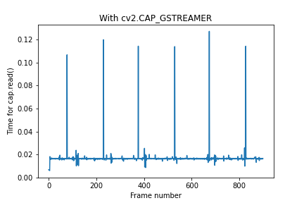

          I'm diving into this a bit more. Thanks to Yevhenii I'm now using the gstreamer backend to opencv.
          I've tested the time it takes to capture individual frames, with Now at 60fps, so a single frame should take 16.7ms. This works out for most frames, but there's a strange pattern of frames that take a lot longer:
          The number of frames between the frame that stalls is 153, 146, 153, 145, 153, 146, 153, 146, ... (this goes on for at least 100 times, so it's a real pattern).

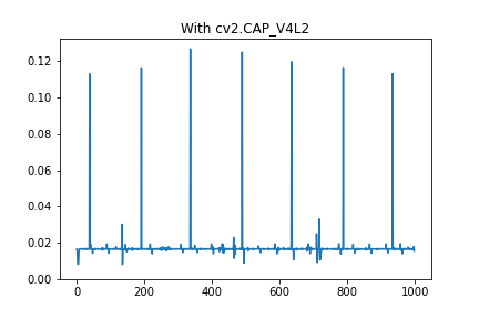

          The opencv v4l2 backend gives a similar result:
          I have not tried to make this plot with the D_mipicamera python library, but I suspect a very similar behavior.
          This is probably also the reason the average goes below 50 in the above questions. Does this ring a bell?
            veye_xumm @tj last edited by
            @tj
            You have done very nice work.
            1. The current driver only supports 720p@60fps, but it doesn't support 720p@50ps yet. But we have plans to support flexible frame rate configuration.
            2. This is indeed a bug, that seems to lose a few frames in a while. I'll arrange to fix it.
            3. There is now a temporary solution.Configure the camera as the master of sync mode.
            ./cs_mipi_i2c.sh -w -f streammode -p1 1 -p2 0
            veye_xumm T 2 Replies Last reply Reply Quote 0
              veye_xumm @veye_xumm last edited by
              @tj
              We have fixed this bug. Please upgrade the camera firmware and test.
              http://wiki.veye.cc/index.php/CS-MIPI-IMX307_version_log
              Regards!

                tj @veye_xumm last edited by
                @veye_xumm Thanks for the quick reply and the workaround!
                I tried setting the camera to master and redid the experiments. It seems that the cv2.CAP_V4L2 gives a slightly more constant framerate, so I'll skip gstreamer.
                    @veye_xumm Thanks for the quick fix! I've installed 2.39 and tested; the regular pattern of missed frames is now gone.
                    I've also tried with 2.39 in master mode, it gives a similar pattern. The regular pattern sometimes a somewhat longer read time (this pattern appears about every 48 frames) is very acceptable. Also, missing one frame in 2000 frames isn't a big problem.
                    Thanks again! Next problem in a next topic 😉
