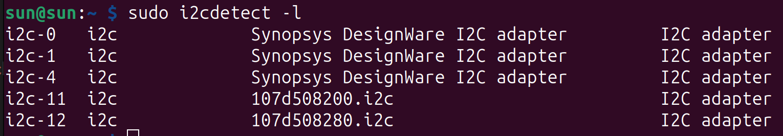

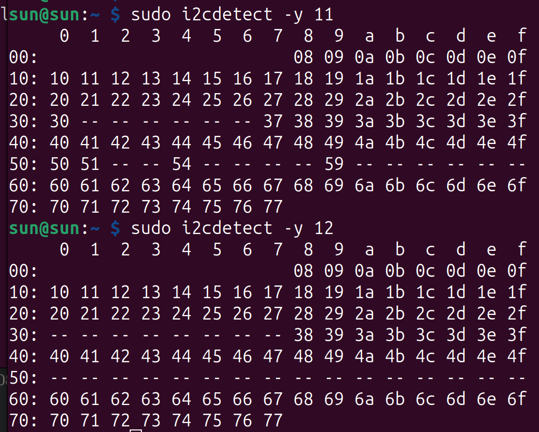

      用树莓派5 CAM1可以打开并设置相机,但是CAM0口找不到相机。
      尝试更换了相机,单独插在CAM0口上还是识别不了。
      mipi接口是i2c-11和i2c-12吗?这两个接口好像是正常的。

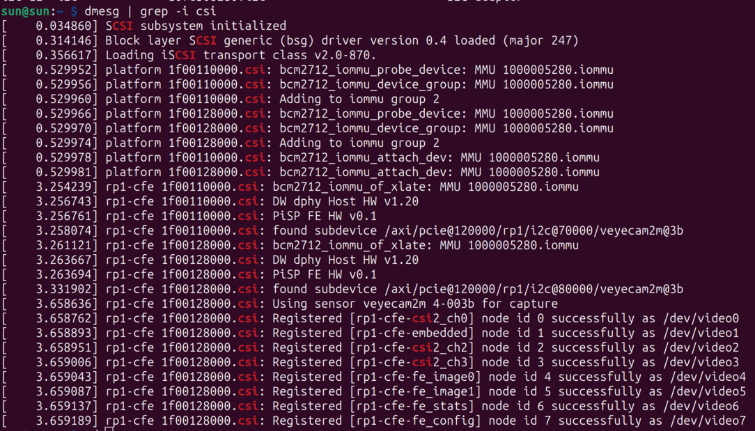

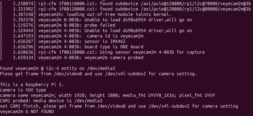

        Hi, I had similar issue with another camera vendor and it was related to overlay file which was from RPi4.
        And fixed by replacing :
        cam0 = <&i2c_frag>, "target:0=",<&i2c_vc>
        to
        cam0 = <&i2c_frag>, "target:0=",<&i2c_csi_dsi0>
        Did you install driver from "release" folder or built it manually from source code?
        if manually you need use dts(dtbo) file from rpi-6.1.y-bookworm folder.
        Correct camera location should be:
        /axi/pcie@120000/rp1/i2c@88000/veyecam2m@3b
        /axi/pcie@120000/rp1/i2c@80000/veyecam2m@3b
        As I see your second camera on ic2@70000 similar as I had with wrong overlay file.

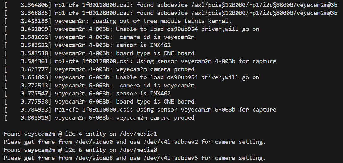

          sqf121 @alex_ai last edited by sqf121
          @alex_ai
          Thank you for your reply.
          I used the script from the release folder to install the driver, and the operating system version is 6.6.20-1+rpt1.
          So, while installing the driver, I think the DTS file used by the script is raspberrypi_v4l2/driver_source/dts/rpi-6.6.y/veyecam2m-overlay.dts, which already has cam0 = <&i2c_frag>, "target:0=",<&i2c_csi_dsi0>.
          I compiled the source code, and now both cameras are recognized!
