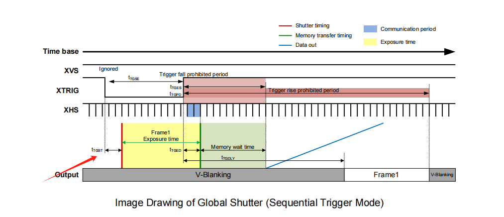

        The first camera outputs a strobe signal to the second camera, which serves as the trigger signal for the second camera.
        However, there is a time delay from when the second camera receives the trigger signal to when it actually starts exposure and outputs the strobe signal, as shown in the diagram below:
        My suggestion is for you to generate a separate trigger signal and simultaneously output this signal to both cameras.
