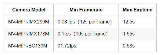

      How to make a long exposure on the MV-MIPI-SC130M camera? Is it possible to change the program code?
      Requires a software trigger to control exposure time up to 1 minute.
      Can any body help me?
        veye_xumm @dm last edited by
        @dm
        With today's camera firmware, the exposure time is limited by the minimum frame rate. To achieve long exposures, you first have to configure a very small frame rate, here are our measurements.
