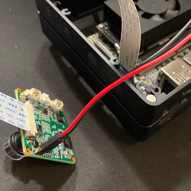

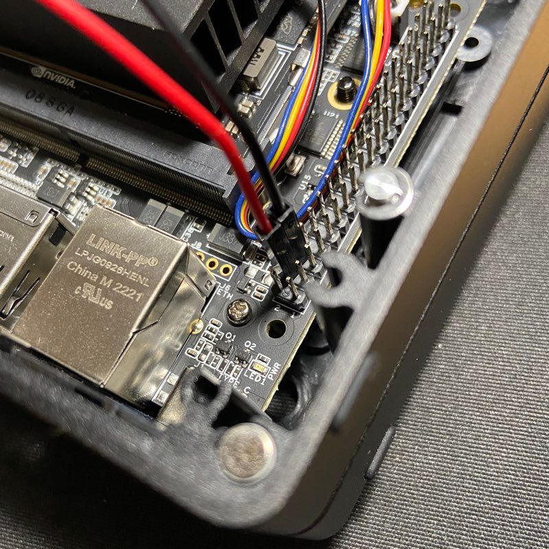

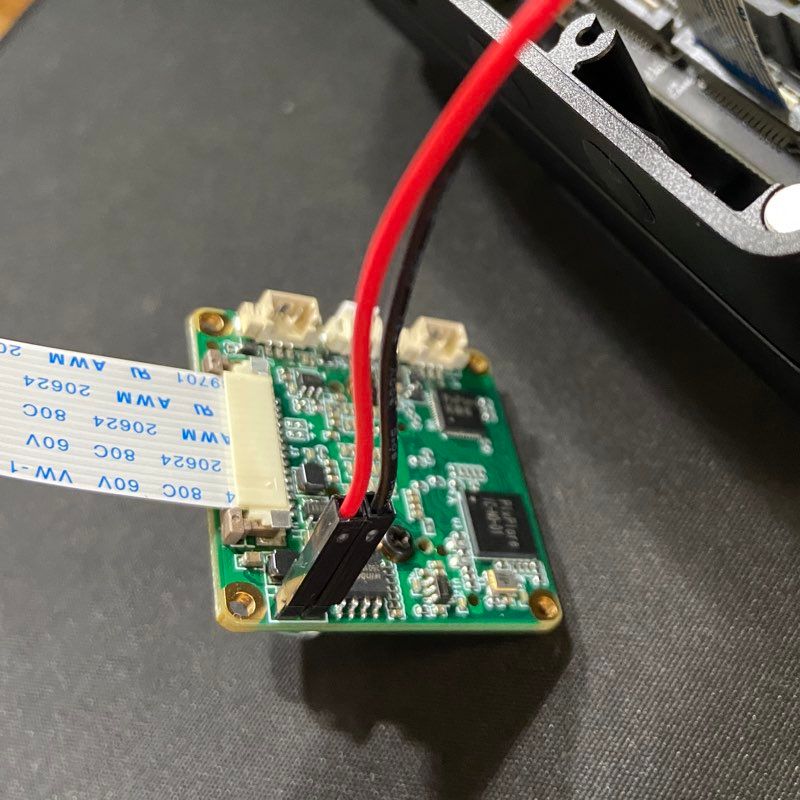

          newleaf last edited by
          Thx for the help!
          Pics attached for verification.
            veye_xumm @newleaf last edited by
            @newleaf
            I think the hardware connection is fine. Please execute the part3.7 and part4.1 command and send me the output to take a look.

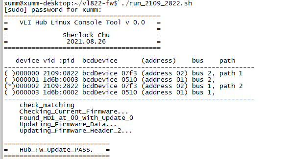

                        **I found a previous document for your reference. **
                        The issue has been traced to a firmware problem with the USB hub chip.
                        Engineers at Seeed have provided a solution, which I have verified to be effective.
                        The specific steps are as follows:
                        STEP 1. Use SSH to remotely log in to your Orin Nano or Orin NX, as during the upgrade process, it is required that no external devices be connected to the USB interface.
                        STEP 2. Find a way to copy the compressed file in the attachment to the Jetson system. If using a USB drive to copy, remember to unplug the USB drive after the copy is complete.
                        STEP 3. Follow the instructions below to perform the upgrade.
                        $ tar -xjvf vl822-fw.tar.bz2
                        $ cd vl822-fw

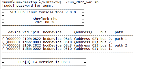

                        STEP 4. Power off and wait for 5 seconds before powering on again. Then, execute the command below to confirm the version of the USB hub firmware.
                        $ ./run_2822_ver.sh
                        STEP 5.
                        Congratulations, the upgrade has been successful. You should now be able to use i2cdetect to detect the VEYE camera at 0x3b.
