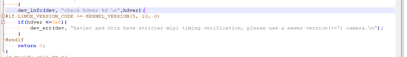

            使用Jetson Orin nano &MIPI 327E,jetson pack 5.1.2,但驅動回報如下,請問如何處理,感謝
            [ 107.875905] veyecam: module verification failed: signature and/or required key missing - tainting kernel
            [ 107.896881] veyecam 9-003b: camera id is veyecam
            [ 107.902269] veyecam 9-003b: sensor is IMX327
            [ 107.906698] veyecam 9-003b: board type is TWO board
            [ 107.911907] veyecam 9-003b: Xavier and Orin have stricter mipi timing verification, please use a newer version(>=7) camera.
            [ 107.937255] veyecam 10-003b: probe failed
            [ 107.941498] veyecam 10-003b: board setup failed
              veye_xumm @Paul Chang last edited by
              @paul-chang
              你可以先忽略这个提示,直接按照wiki文档的说明,继续测试一下取图等功能。
              P 1 Reply Last reply Reply Quote 0
              • P
                Paul Chang @veye_xumm last edited by
                @veye_xumm 動態連結.ko,這個訊息是驅動主動發的,之後就退掉了,無法再向下測測
                  @paul-chang
                  这个只是一个提示信息,不影响驱动加载和后续测试的。
                  你可以看看有没有生成/dev/video0,如果没有,看看dtb是不是用对了。
