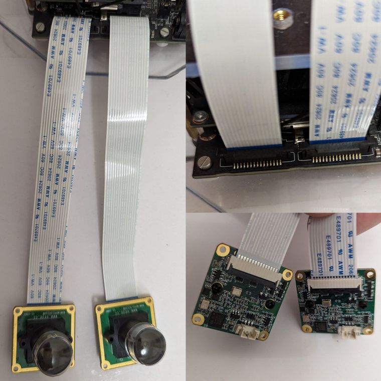

              Antony @veye_xumm last edited by
              Connections looks correct.

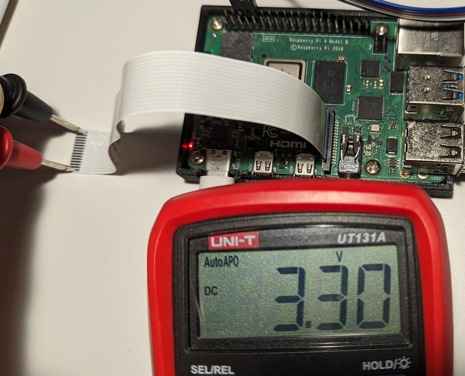

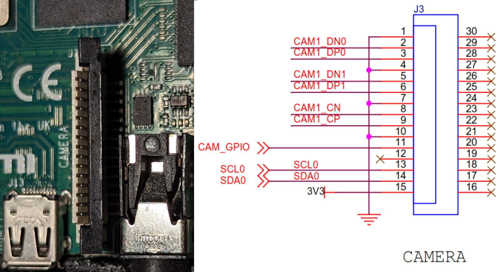

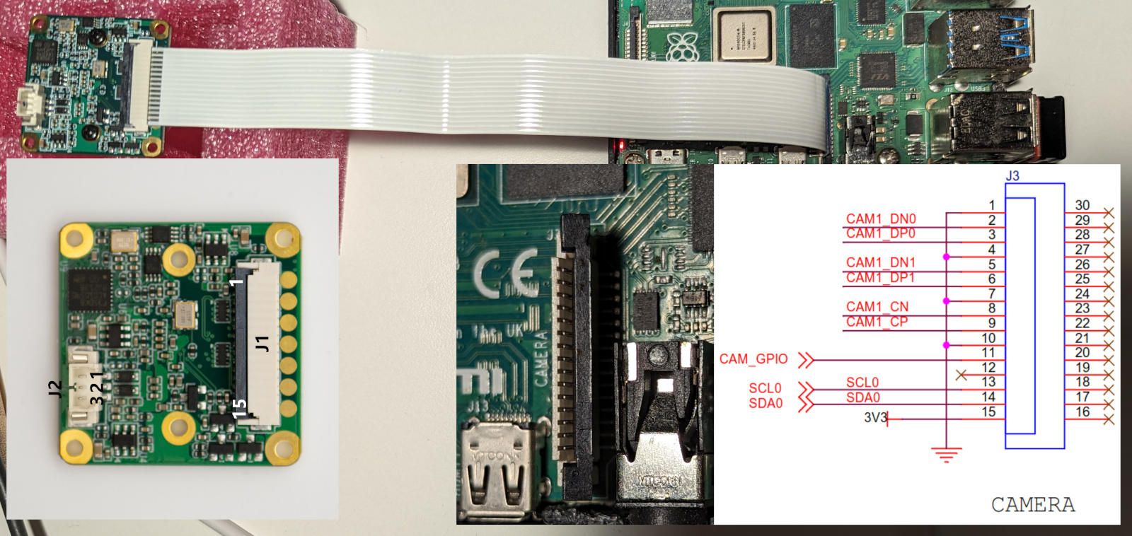

                    I've examined Raspberry PI 4 Model B schematics. According to schematics, camera connector has the following pinout and there is only one way to connect FFC cable to the connector.
                    I also checked that the GND pin is on the top and the 3V3 pin is on the bottom.

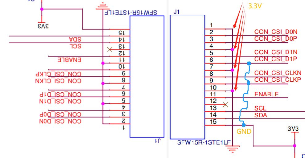

                    Entire connection diagram is as follows and this is the configuration I've used from the very beginning.

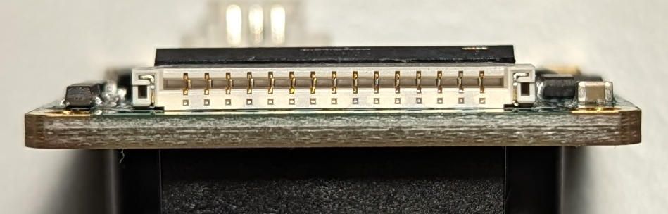

                    Since the camera connector allows FFC cable to be connected on both sides, I've connected cable with the opposite side.
                    In such connection scheme, the Raspberry Pi failed boot. It looks like there is a short circuit somewhere. But, Jetson Nano can handle that load ))) According to the readings from my power supply, power consumption increased from 2W to 10W and camera module gets extremely hot. It doesn't look like camera can work with such connection scheme.
                    Even after these experiments, I was able to connect to the camera and it did not report any errors.

                      veye_xumm @Antony last edited by
                      @antony
                      You've made a very accurate analysis and testing, which is admirable.
                      For this camera model, to save space, we use a double-sided contact connector, which indeed has caused some issues. We are planning to improve this module by replacing it with a 22-pin single-sided contact connector.
                      I, together with our hardware colleagues, conducted an analysis, and the results align with your test findings.
                      After reconnecting the FFC cable correctly following a reversal, the sensor's registers and error codes did not indicate a damaged state for the camera.
                      In the case of reversed power connection, the pins that are actually damaged are CON_CS_D1P and CON_CSI_CLKP. Unfortunately, this issue cannot be detected through software.
