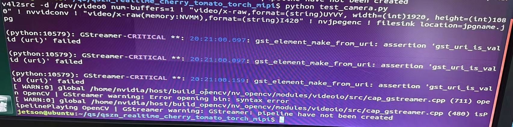

              lyj @veye_xumm last edited by
              cap = cv2.VideoCapture('v4l2src -d /dev/video0 num-buffers=1 ! \"video/x-raw,format=(string)UYVY, width=(int)1920, height=(int)1080\" ! nvvidconv ! \"video/x-raw(memory:NVMM),format=(string)I420\" ! nvjpegenc ! filesink location=jpgname.jpg')
                veye_xumm @lyj last edited by
                @lyj
                这脚本不是直接这样扔到python代码里面的啊。
