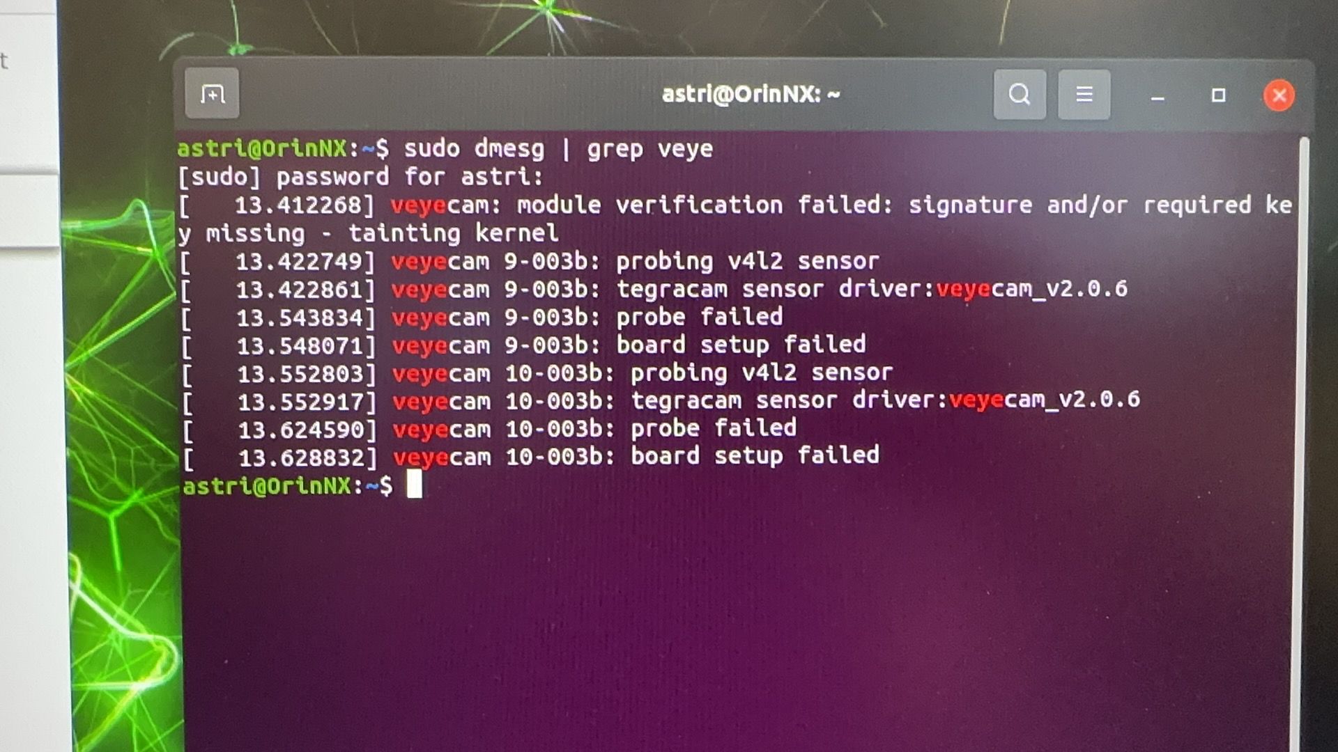

      Dear all, I purchase VeYe IM462 camera module and connect to Jetson Orin NX 8G (with carrier board J401 from seeed studio), I follow the wiki step etc but fail to get the driver work. I try the jetpack 5.1.1 with L4r35.3.1; Jetspack 5.1 with 35.2.1 also, but still fail to detect the camera. Can anyone have advise fImage5.jpeg or me ?Imag8.jpeg Image.jpeg

        @vincentng seeed的J401底板上,的确i2c访问VEYE 462模组是不通的。这个问题我们跟seeed的人在沟通,但是他们的技术支持比较消极。

                    The current situation is that even i2cdetect cannot detect the VEYE camera properly, so I believe that adjusting the higher-level driver logic will not be useful.

                                @vincentng We had the same problem with our 462 on the J202 with an Xavier NX Module. We ended up purchasing A206 boards and they worked fine. ReComputer uses a raspberry pi chip for power management on their carrier boards. I think it communicates over i2c I think. I think this is where the problem lies. We never dug into it any further. If there is a solution, I would be eager to know about. I would also be interested to know if your Orin NX works with a more generic carrier board and the IMX462. We may need that combination for our project soon. Good luck.

                                    Seeed's engineers have already solved this problem and it requires upgrading the firmware of the USB hub chip.
                                    If necessary, you can contact Seeed's engineers or wait for Seeed to officially release the solution.
