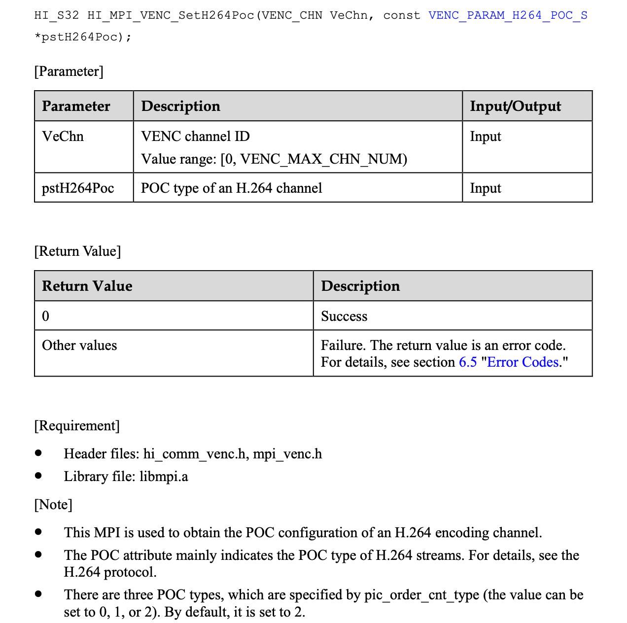

                            When I search the firmware for the Hi3516v200 I find the following reference
                            h264e_set_poc
                            inside
                            hi3516ev200_h264.ko
                            poc pretty much always stands for "pic_order_count_type" in this context.
                            So I doubt it is a hardware limitation by the encoder.
                            Especially since there is also the following comment:
                            pic_order_cnt_type err, should in [0,2]
                            e.g. poc_type can be in the range [0,2] where 2 is what I was asking for.

                                        Consti10 @veye_xumm last edited by
                                        Thank you for this conclusive response. Maybe your subsidary who provides the sw for the encoder chip can do something though -
                                        From the official documentation for Hi3518 i found out that they actually use poc_type=2 by default.
                                        So it is likely that the sw you are using is manually setting poc_type=0.
                                        For the OpenHD project, we test a lot of usb cameras. They all share the poc_type bug though (I refer to it as bug here, because it makes the camera unusable for low latency streaming on a lot of platforms).
                                        Whoever is the first one to bring a usb camera to market with HiXXX chip and poc_type=2 basically has the lowest latency h264 usb camera on the market paired with rpi or snapdragon as decoder.
