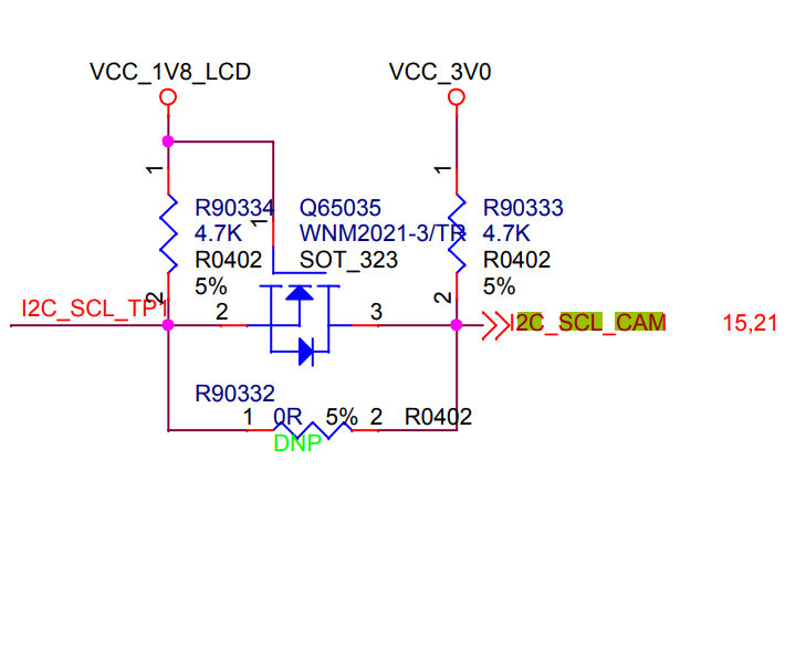

        RAW-MIPI-SC132M do not support 1.8V I2C bus. Raspberry Pi Camera v2.1 (IMX219)
        The IMX219 is the same. Due to the circuit below, I think the I2C of the Orange Pi is a 3.3V level too.

          @veye_xumm that's really strange but IMX219's I2C DOES work just fine with 1.8V I2C bus.
          Orange Pi 4 LTS uses 1.8V I2C bus, I did the measuring and here's a pic:

          I don't know where you got this screenshot from, here is a link to their schematics - link
          So my question was: is I2C level shifter is of any good here? and may I have your cam schematics?

            I simply found a schematic on the orange pi website and looked at it. What you may see is not the schematic of the board you have.
            One thing is for sure, is that our camera module does not support 1.8V I2C level standard.

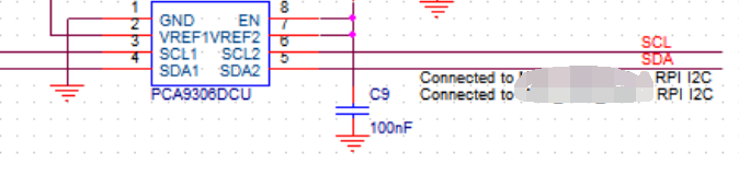

                    The right side of the picture below shows the external I2C circuit of the RAW-MIPI-SC132M.
                    We have no plans to connect to the orange pi for now. We are porting our MV and RAW cameras to firefly's ROC-RK3566-PC and ROC-RK3588S-PC, and we have already made an adapter board for them.

                      @veye_xumm Thanks, just used a PCA9306 level shifter and it works perfectly.
