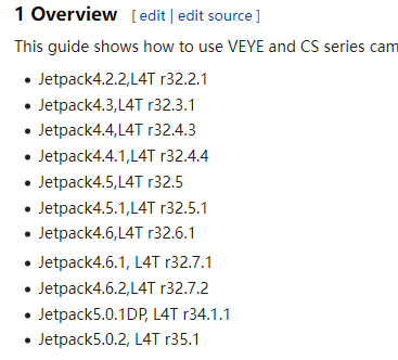

                  http://wiki.veye.cc/index.php/VEYE_CS_Camera_for_Jetson_TX2
                  For the original system version of the motherboard, we have provided the corresponding Image and dtb. But Jetpack 4.6.3 is the version that just came out and we haven't had time to port the driver yet.
                  We suggest you to re-burn the motherboard to Jetpack4.6.2 first, then use the corresponding Image and dtb.

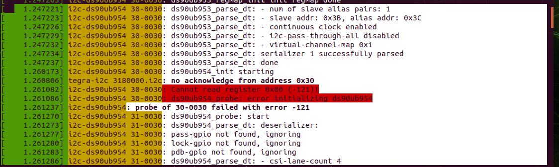

                    Dear,
                    Do you have any ideas on the attached photo image?
                    first time ds90ub954 has successed but at the point it fails to access to 0x30 and
                    it causes camera drivers access failure I think.
                      chjchoi @chjchoi last edited by
                      @chjchoi On the last photos .. the chip information and not important to functioning.
                      So iwill block the error and will go ahead of test.
                        veye_xumm @chjchoi last edited by
                        @chjchoi I think this place means that the 954 chip is not detected properly on the i2c.
