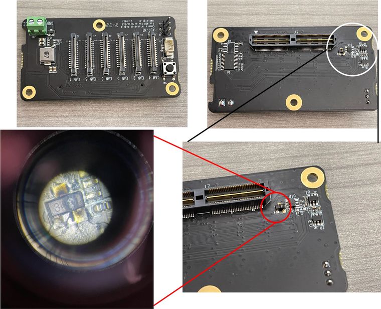

      I have a Jetson AGX Orin which connect to power supply using the USB-C connector.
      I ordered IMX335 which came with ADP-N1-V2.0 Adapter board. When I connected the adaptor to the Jetson board, one component got burned. I didn't connect the adaptor to any power supply.
      Please attached images.

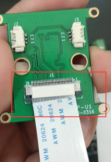

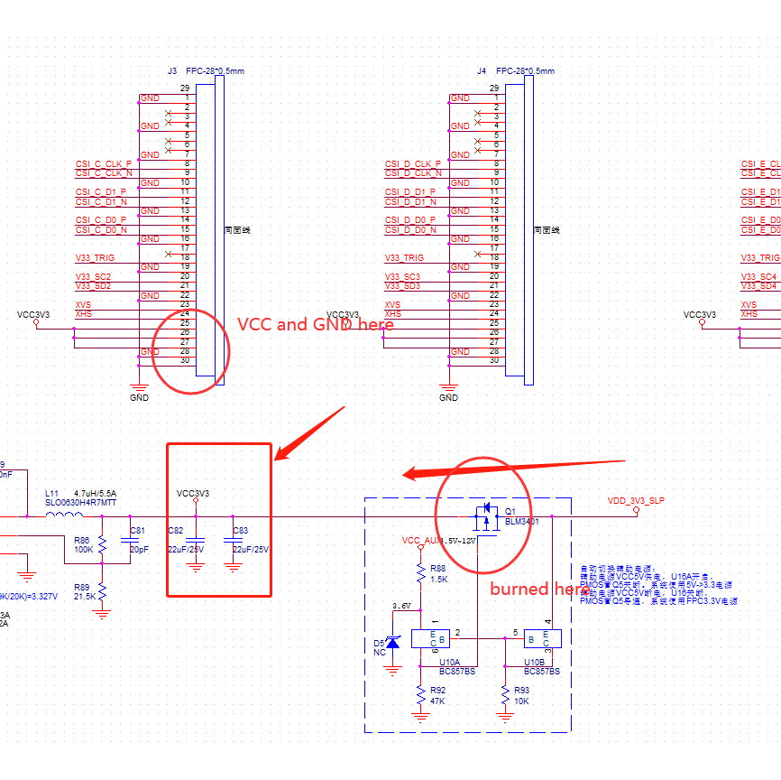

        This device you burned is BLM3401.
        After discussion, our engineers think that the most likely cause of the problem is that you did not plug in the FFC cable properly, resulting in a short circuit between 3.3V and GND.
        Please refer to the figure below.
        The following post part of the schematic for your reference.

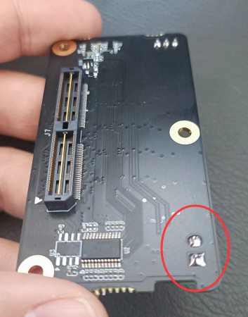

            Another possibility is that your adp-n1 board is not flat enough when you plug it into the orin. The two protruding places below are shorted to the orin somewhere.
            • H
              hchorsi last edited by
              This might be the case with my adaptor board since mine also looks like it not flat.
