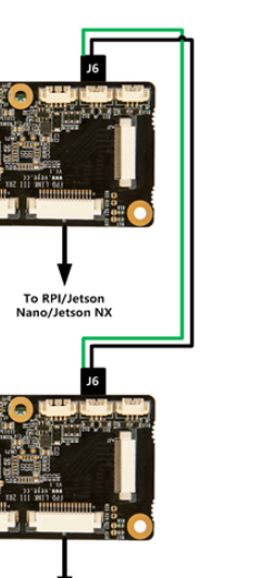

      1. The wiring is as follows.

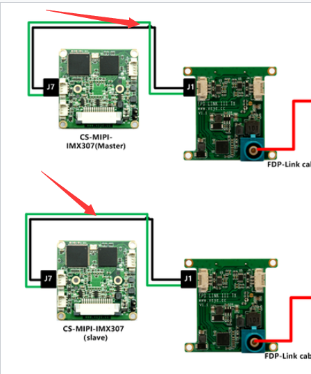

          http://wiki.veye.cc/index.php/FPD_LINK_III_for_Jetson#CS-FPD-CAM-IMX307_sync_mode.EF.BC.8Cconnnect_to_Jetson_Nano_B01.2FNX
          Please check these connection:

          1. Wiring (J1-J7)

                I think you use the wrong pin for SYNC signal. You should use J7-3 and J1-3, not J7-1 and J1-1.
                SYNC signal connect J7-3 to J1-3,J7-2 to J1-2.
                O 1 Reply Last reply Reply Quote 0
                • O
                  octa_yk @veye_xumm last edited by
                  Thank you very much.
                  I fixed the wiring and was able to import the video successfully.
