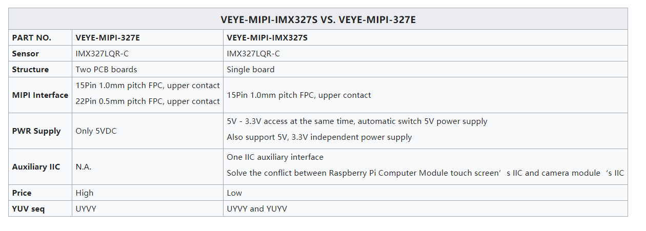

                @veye_xumm Is it possible to switch to YUYV on VEYE-MIPI-327 ?
                  veye_xumm @jk last edited by
                  @jk
                  hi,VEYE-MIPI-327 do not support this feature.
                  VEYE-MIPI-327S support and it is our recommended model for the future.
                  http://wiki.veye.cc/index.php/VEYE-MIPI-327S_STARVIS_Module_index
