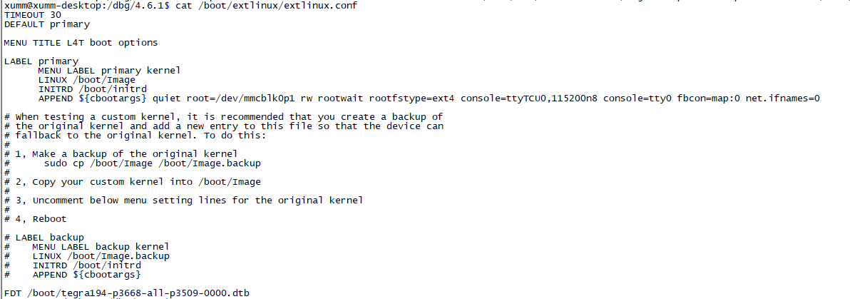

              veye_xumm @techies last edited by
              @techies
              Sorry reply finished. China took a 7 day holiday. We just got back to work.
              There is no tab in front of FDT.
