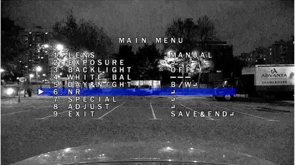

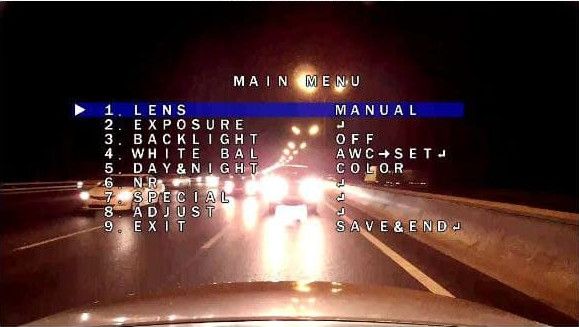

      Hello.
      Already on two copies of the camera VEYE-MIPI-IMX327S, a menu appears:
      The menu cursor moves spontaneously...
      What it is?
      How do I prevent the menu from appearing?
