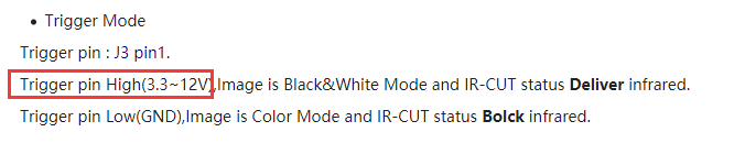

                                      1. I think you need this cmd.
                                        http://wiki.veye.cc/index.php/VEYE-MIPI-290/327_i2c/#irtrigger

                                          It is my solution now:
                                          sudo ./veye_mipi_i2c.sh -w -f irtrigger -p1 1 -b 10
                                          sudo ./veye_mipi_i2c.sh -w -f ircutdir -p1 1 -b 10
                                          Please update imx327s wiki, there no irtrigger cmd.
