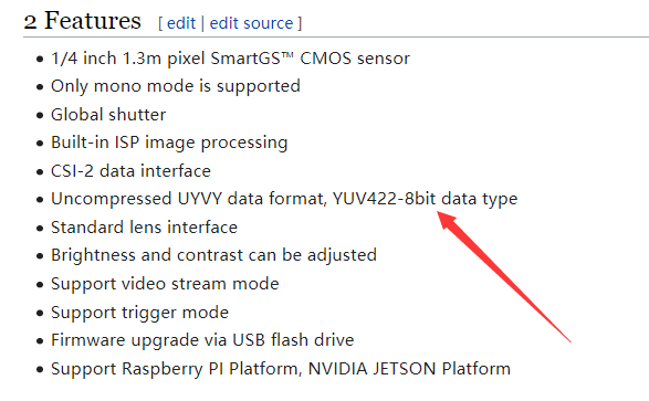

          The datasheet says it is possible to get 8-bit uncompressed data, is that true or not? I've tried making a PTC curve with the Y-component of YUV images (which should contain the full black-white image or mono image), but it didn't look good so there probably still was some compression going on.

            The camera contains a fully functional isp module. The output signal of sensor is indeed 10bit raw, but the YUV data output by the camera is not the result of simple mathematical operation of sensor data.
            I don't think it is suitable for making PTS curve.
