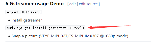

                bash: gst-launch-1.0: command not found
                  veye_xumm @esjeeybi last edited by
                  @esjeeybi
                  http://wiki.veye.cc/index.php/V4L2_mode_for_Raspberry_Pi#Gstreamer_usage_Demo

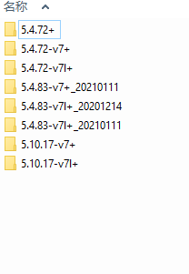

                    Hey I have a problem again I have updated raspbian and I need the following files.
                    usage: sudo ./install_driver.sh veyecam2m/veye327/csimx307/cssc132
                    Enable i2c0 adapter...
                    Add dtoverlay=cssc132 to /boot/config.txt
                    Add gpu=400M to /boot/config.txt
                    Add cma=128M to /boot/cmdline.txt
                    Installing the cssc132.ko driver
                    install: cannot stat './driver_bin/5.10.60-v7l+/cssc132.ko': No such file or directory
                    install: cannot stat './driver_bin/5.10.60-v7l+/cssc132.dtbo': No such file or directory
                    I bought this webcam because it has good UV sensitivity. And he wants to photograph the sun through a UV transmitting filter. If I have to compile each time after the update, you have to show me how to do it, I will be very thankful and I will not bother you.
                      @esjeeybi
                      About how to compile our drivers on rpi:
                      http://wiki.veye.cc/index.php/V4L2_mode_for_Raspberry_Pi#Source_code_cross_compilation
                          @esjeeybi
                          I have compiled the version you need, please check GitHub.
