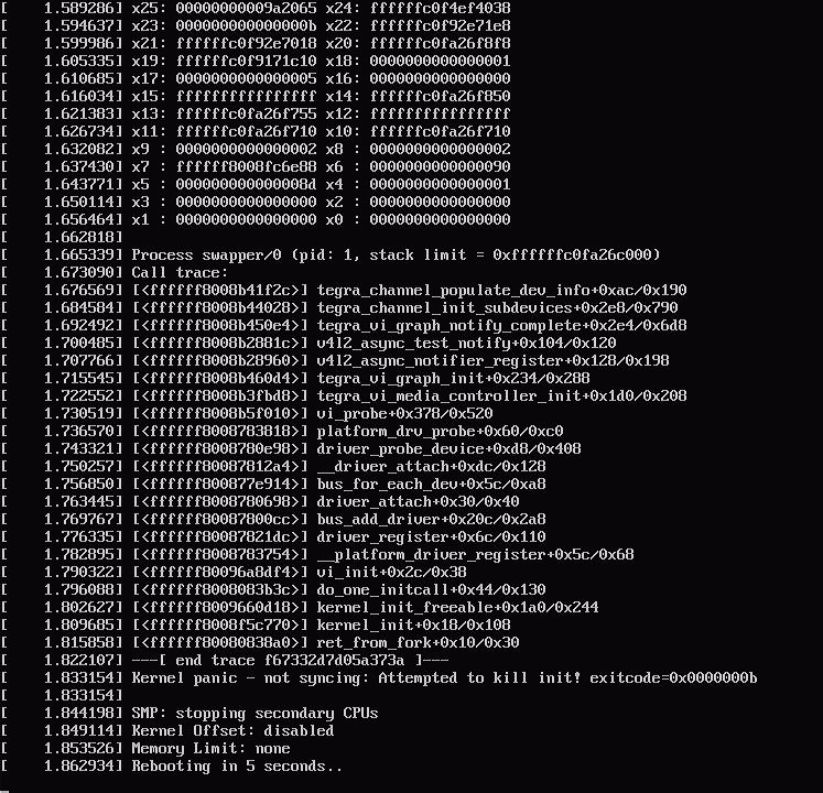

      Hi
      I applied the CS-MIPI-IMX307 dtb file on my Jetson Nano B01.
      When I rebooted the OS, it went into a boot loop.
      Does this not happen in your environment?
      Here is the detailed information.
      Environment:
      JetPack 4.4.1
      Jetson Nano B01
      CS-MIPI-IMX307
      Worked on:
      cat /etc/nv_tegra_release
      # R32 (release), REVISION: 4.4, GCID: 23942405, BOARD: t210ref, EABI: aarch64, DATE: Fri Oct 16 19:44:43 UTC 2020
      git clone https://github.com/veyeimaging/nvidia_jetson_veye_bsp.git --depth 1
      cd nvidia_jetson_veye_bsp
      mkdir kernel_image_l4t_r32.4.4
      tar -xzvf kernel_image/Image_l4t_r32.4.4_veyecam.tar.gz -C kernel_image_l4t_r32.4.4/
      sudo cp kernel_image_l4t_r32.4.4/Image /boot/Image -f
      sudo cp Nano/JetPack_4.4.1_Linux_JETSON_NANO_DEVKIT/dts\ dtb/CS-MIPI-IMX307/tegra210-p3448-0000-p3449-0000-b00.dtb /boot/ -f
      sudo vi /boot/extlinux/extlinux.conf
      + FDT /boot/tegra210-p3448-0000-p3449-0000-b00.dtb
        veye_xumm @octa_yk last edited by
        @octa_yk
        Hi, sorry for that. I think it's a dtb bug by us. You can use jetpack 4.5 version by now.
        And we will fix that bug today. Please look at the github later.
          @octa_yk
          The bug has been fixed, please check the github.
