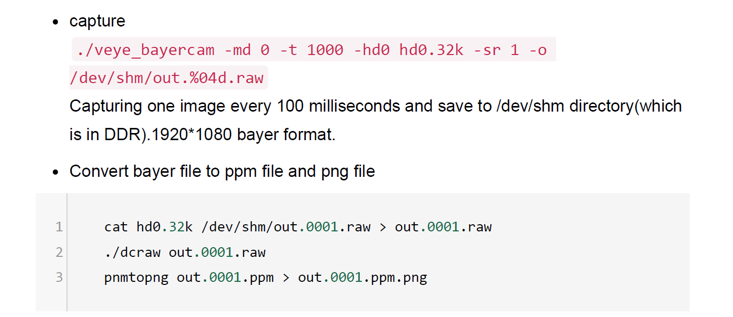

                  @veye_xumm Is there a way to capture with 10 or 12 bit depth as the sensor is capable of?
                  This is part of the manual that I received from you.
                  It seems like this is raw format, no?

                        veye_xumm @Seka last edited by
                        @seka
                        hi, VEYE-MIPI-IMX462 do not support YUV 10BIT/12BIT.
