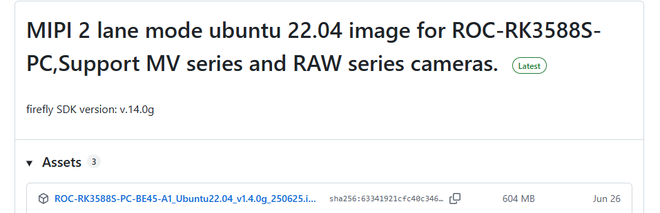

      VEYE MIPI在 roc3588s-pc的板子,直接刷了 您提供的最新的 ec8bf107-6005-429d-adb5-a7550a352ede-image.png 好像不太对,我DMESG是 这样,是不是需要我在firefly 重新编译到最新的linux系统里面,这个版本 已经不支持VEYE系列了

        veye_xumm @flaty last edited by
        @flaty
        您这个截图的镜像是MV和RAW系列的。
        请参考这个链接中的镜像。
        https://github.com/veyeimaging/rk35xx_firefly/releases/tag/v1.7
        F 1 Reply Last reply Reply Quote 0

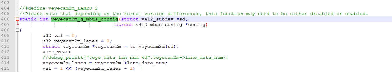

              @veye_xumm 编译错误 我把信息发给您看一下,是驱动里面的结构体
              CC drivers/media/i2c/veyecam2m.o
              drivers/media/i2c/veyecam2m.c: In function 'veyecam2m_g_mbus_config':
              drivers/media/i2c/veyecam2m.c:419:24: error: 'V4L2_MBUS_CSI2' undeclared (first use in this function); did you mean 'V4L2_MBUS_CSI1'?
              419 | config->type = V4L2_MBUS_CSI2;
              | V4L2_MBUS_CSI1
              drivers/media/i2c/veyecam2m.c:419:24: note: each undeclared identifier is reported only once for each function it appears in
              drivers/media/i2c/veyecam2m.c: At top level:
              drivers/media/i2c/veyecam2m.c:898:3: error: 'const struct v4l2_subdev_video_ops' has no member named 'g_mbus_config'
              898 | .g_mbus_config = veyecam2m_g_mbus_config,
              drivers/media/i2c/veyecam2m.c:898:19: error: initialization of 'int (*)(struct v4l2_subdev *, struct v4l2_subdev_frame_interval )' from incompatible pointer type 'int ()(struct v4l2_subdev *, struct v4l2_mbus_config *)' [-Werror=incompatible-pointer-types]
              drivers/media/i2c/veyecam2m.c:898:19: note: (near initialization for 'veyecam2m_video_ops.s_frame_interval')
              cc1: all warnings being treated as errors
              make[4]: *** [scripts/Makefile.build:273:drivers/media/i2c/veyecam2m.o] 错误 1
                  @flaty
                  参见代码的注释,你的内核缺少这个接口,需要注掉这个函数。
