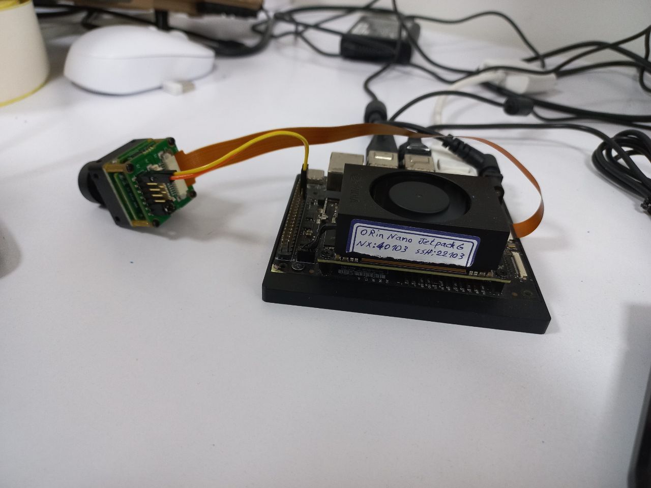

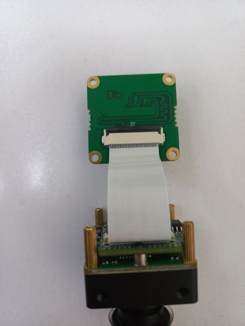

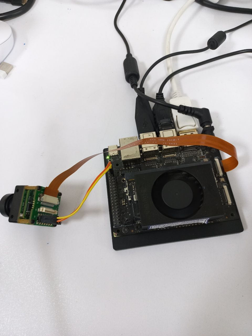

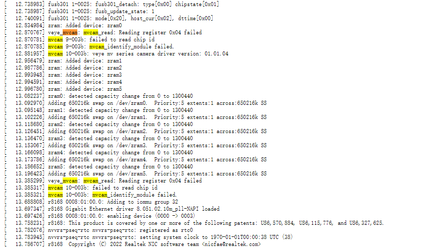

                  veye_xumm @Otca last edited by
                  @otca said in NVidia Jetson Jetpack 6 support?:
                  [ 12.536185] mvcam 9-0010: failed to read chip id
                  [ 12.536190] mvcam 9-0010: mvcam_identify_module failed.
                  [ 13.041253] veye_mvcam: mvcam_read: Reading register 0x04 failed
                  [ 13.041269] mvcam 10-0010: failed to read chip id
                  [ 13.041273] mvcam 10-0010: mvcam_identify_module failed.
                  From this prompt message, it looks like your driver and dtb are doing the right thing. But now i2c probe can't get the device.
                  Please make sure your 5V dupont cable is plugged into the right place? I can't see it clearly from the picture.
                  O 1 Reply Last reply Reply Quote 0

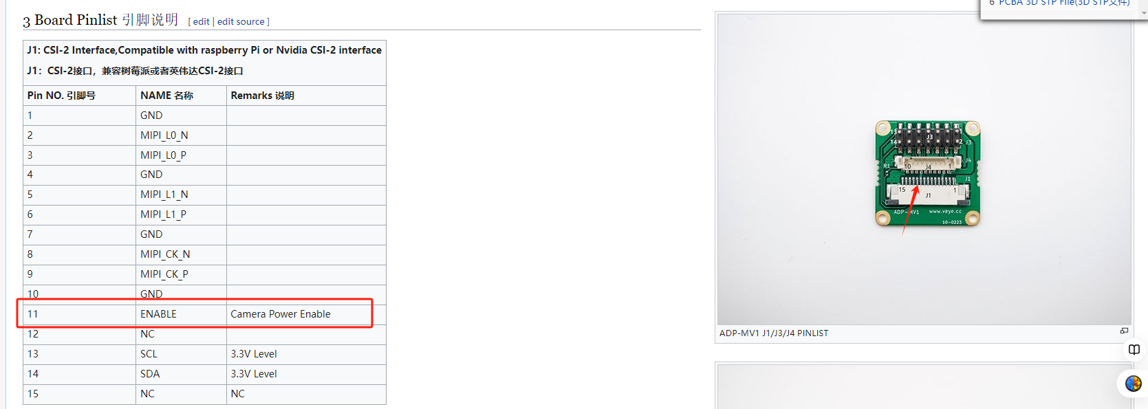

                    5V dupon
                    Thnaks for fast replay
                    To double check the pin of IMX264 would u please tell me which one is 5V and which one is GND?

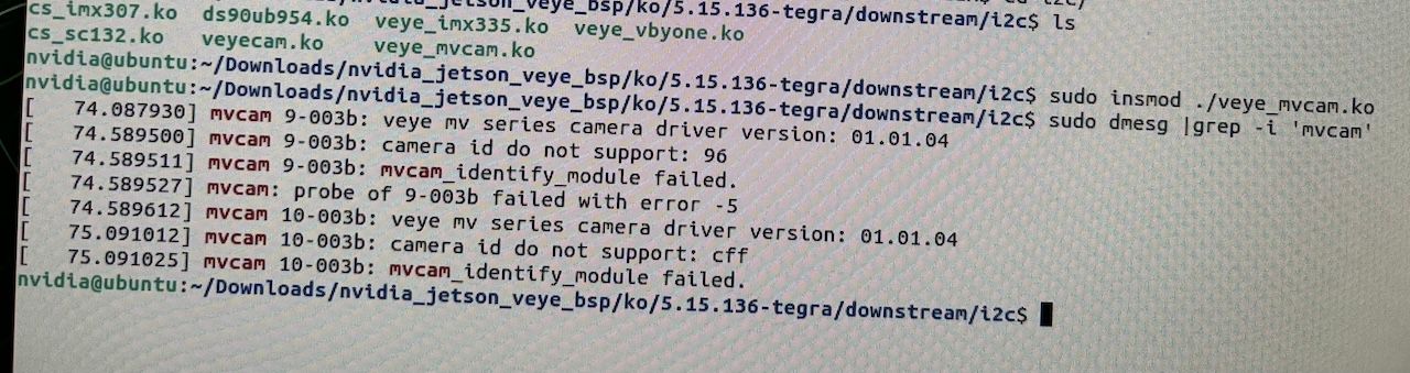

                                    @otca
                                    I would say that this phenomenon now has nothing to do with the details of the dts. The problem now is that i2c doesn't work.
                                    This is often something to do with the hardware connection cables, and whether the camera is working properly.
                                    Do you have a multimeter? An oscilloscope? Can you measure the power supply to the camera module, and whether the i2c communication is working?
                                      @otca
                                      Have you ever disassembled the camera module?Is the direction of the internal FFC flex cable correct?

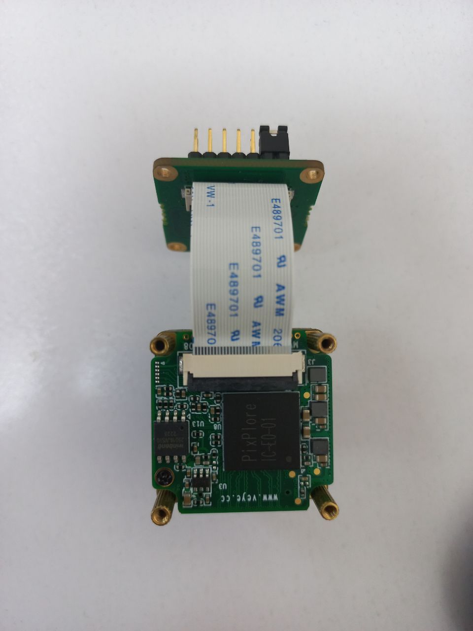

                                      • O
                                        Otca @veye_xumm last edited by
                                        @veye_xumm said in NVidia Jetson Jetpack 6 support?:
                                        I have not disassembled camera but if you think i should disassemble and check connections, I'll give it a try.
                                        if its possible please give me reference needed for this part.
                                        and for the other question, I did check the power supply and it was 5.14 V.
                                        • O
                                          Otca @Otca last edited by
                                            @otca
                                            There's nothing wrong with that in my opinion. You have 4 cameras, have you tried any others?
                                            Or try plugging the camera into another mipi port ?
