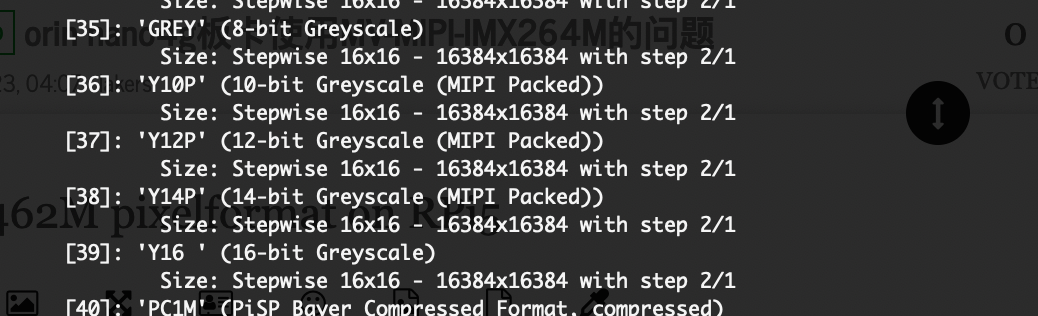

      Hi, I'm trying to get image from IMX462M on RPi5.
      Driver Installed, I can use mv_mipi_i2c.sh tool but can't get image.
      According to documentation for v4l2-ctl I should set pixelformat='Y10 ' but seems like v4l2-ctl doesn't support it (returns: The pixelformat 'Y10 ' is invalid) .
      v4l2-ctl --list-formats-ext returns only next supported mono formats:
      with 'Y10P' it returns : VIDIOC_STREAMON returned -1 (Invalid argument)
      Could you please advise how to fix it?
        veye_xumm @alex_ai last edited by
        @alex_ai It seems that the new version of the Raspberry Pi 5 removed 'Y10 ' support from the system. My first thought was to modify the media_setting_rpi5.sh file to change 'Y10 ' to 'Y10P', I wonder if that would work?

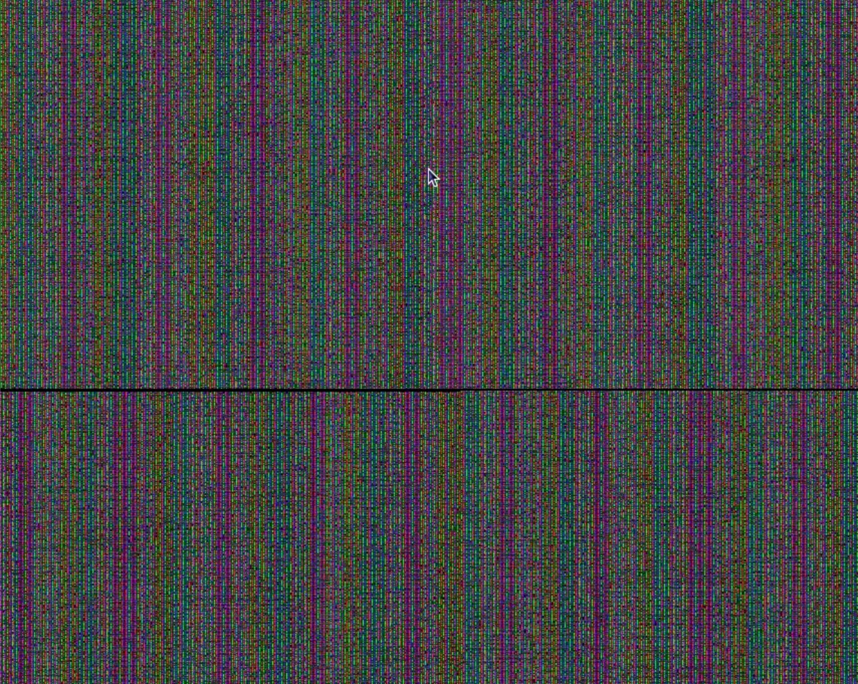

          I reinstalled driver from fresh sources and updated format to Y10P in media_setting_rpi5.sh.
          Now command : v4l2-ctl -d /dev/video0 --set-fmt-video=width=1920,height=1080,pixelformat='Y10P' --stream-mmap=3 --stream-count=1 --stream-to=y10-1920x1080.raw
          saves file but I can't open it, what application should I use? all my applications which supports raw formats could not recognise this file.
          Also I tried open stream in qv4l2 application, it could open but video image broken
          A 1 Reply Last reply Reply Quote 0

            alex_ai @alex_ai last edited by
            @alex_ai said in IMX462M pixelformat on RPi5:
            Hi @veye_xumm
            Hi, I managed to decode mipi packed raw format in rawfile_to_opencv_show.py file and seems like problem is not only in pixel format. If you look to image bellow : it has 6 same small areas which overlaps each other
            Also enabled "test image" in camera configuration and it looks similar:
            It is most probably driver issue or hardware issue.
            What is else I can try to modify?
              @alex_ai
              I found this information on the Raspberry Pi official website.
              Previously, we used the unpacked format as it was convenient for customers. However, it seems that the Raspberry Pi OS has now removed the unpacked format and only retains the packed format (or is there some way to configure this?). We need some time to investigate this further. The information below is for reference.
              mode
              Allows you to specify a camera mode in the following colon-separated format: <width>:<height>:<bit-depth>:<packing>. The system selects the closest available option for the sensor if there is not an exact match for a provided value. You can use the packed (P) or unpacked (U) packing formats. Impacts the format of stored videos and stills, but not the format of frames passed to the preview window.
              Bit-depth and packing are optional. Bit-depth defaults to 12. Packing defaults to P (packed).
              For information about the bit-depth, resolution, and packing options available for your sensor, see list-cameras.
              Examples:
              4056:3040:12:P - 4056×3040 resolution, 12 bits per pixel, packed.
              1632:1224:10 - 1632×1224 resolution, 10 bits per pixel.
              2592:1944:10:U - 2592×1944 resolution, 10 bits per pixel, unpacked.
              3264:2448 - 3264×2448 resolution.
              Packed format details
              The packed format uses less storage for pixel data.
              On Raspberry Pi 4 and earlier devices, the packed format packs pixels using the MIPI CSI-2 standard. This means:
              10-bit camera modes pack 4 pixels into 5 bytes. The first 4 bytes contain the 8 most significant bits (MSBs) of each pixel, and the final byte contains the 4 pairs of least significant bits (LSBs).
              12-bit camera modes pack 2 pixels into 3 bytes. The first 2 bytes contain the 8 most significant bits (MSBs) of each pixel, and the final byte contains the 4 least significant bits (LSBs) of both pixels.
              On Raspberry Pi 5 and later devices, the packed format compresses pixel values with a visually lossless compression scheme into 8 bits (1 byte) per pixel.
              Unpacked format details
              The unpacked format provides pixel values that are much easier to manually manipulate, at the expense of using more storage for pixel data.
              On all devices, the unpacked format uses 2 bytes per pixel.
              On Raspberry Pi 4 and earlier devices, applications apply zero padding at the most significant end. In the unpacked format, a pixel from a 10-bit camera mode cannot exceed the value 1023.
              On Raspberry Pi 5 and later devices, applications apply zero padding at the least significant end, so images use the full 16-bit dynamic range of the pixel depth delivered by the sensor.
              https://www.raspberrypi.com/documentation/computers/camera_software.html#common-options
              • A
                alex_ai @veye_xumm last edited by
                Thank you for documentation, I used wrong algorithm to decode 10 bit packed format.
                According to doc:
                I fixed it and can open raw image from python, but anyway need find way how to decode video in real time, because now decode one frame is about 3 seconds.
                Same Image as above:

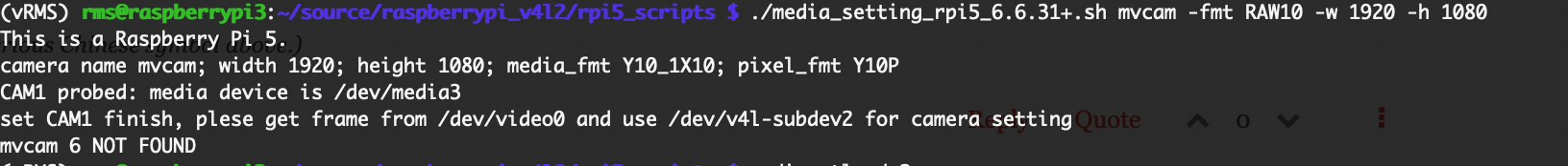

                          Hi, it helped but I had to use 1.0.6 tag of libpisp, with the latest version I had compile errors.
                          Now for command : rpicam-hello -v
                          I have this error:
                          I used set media script before:
                          Maybe forgot something else.
                            @alex_ai ./media_setting_rpi5**.sh is not necessary.
                            A 2 Replies Last reply Reply Quote 0

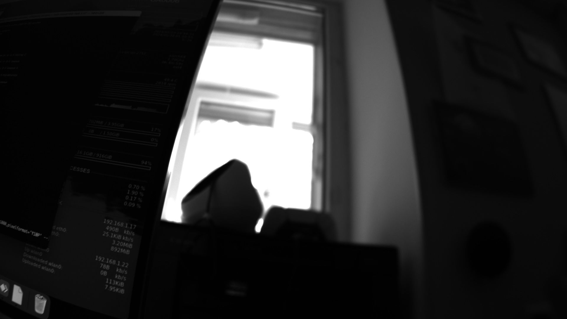

                              Hi, I noticed that version of libcamera different on my screenshot (it 0.2.0 but I installed 0.3.0)
                              I uninstalled rpicam-apps and rebuild it from source code again and it uses my version of libcamera now.
                              if execute rpicam-still -v I have next error:
                              In commit I see added json file only to vc4 folder (for RPi4) , can we add it to pisp folder (for RPi5) it should have name : "mvcam_mono.json"? it has different format and can't use same file from vc4.
                              Also I managed start video by this command:
                              rpicam-still --tuning-file /source/libcamera/src/ipa/rpi/pisp/data/uncalibrated.json -t 0
                              and it works!
                              But better run it without additional parameters
                              Thank you.
