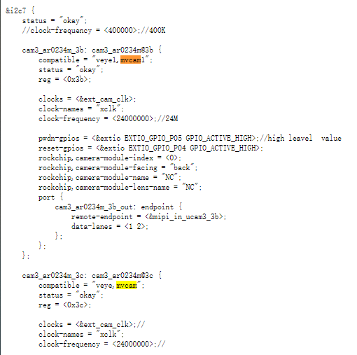

      @veye_xumm said in 相机采集图像阻塞:
      另外你在i2c-7上面挂了两个相机?即便是这样,也没有必要做两个完全一致的ko插入到系统里面去
      我现在只在设备树添加一个相机,设备树中对相机时钟有要求吗?
        @lin
        @lin said in 相机采集图像阻塞:

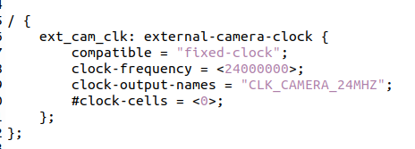

        没有要求,相机自己有时钟。
        OK3588-C-Camera.dtsi中,i2c-7这一路,你可以参考一下下面这部分代码。
        //***  CAM3 VEYE MVCAM Configuration Description  ****
        &csi2_dphy0_hw {
            status = "okay";
        &i2c7 {
            status = "okay";
            clock-frequency = <400000>;
            cam3_mvcam: cam3_mvcam@3b {
                compatible = "veye,mvcam";
                status = "okay";
                reg = <0x3b>;
                clocks = <&ext_cam_clk>;
                clock-names = "xclk";
                clock-frequency = <24000000>;
                pwdn-gpios = <&extio EXTIO_GPIO_P05 GPIO_ACTIVE_HIGH>;
                //enable-gpios = <&extio EXTIO_GPIO_P05 GPIO_ACTIVE_HIGH>;
                reset-gpios = <&extio EXTIO_GPIO_P04 GPIO_ACTIVE_LOW>;
                rockchip,camera-module-index = <0>;
                rockchip,camera-module-facing = "back";
                rockchip,camera-module-name = "NC";
                rockchip,camera-module-lens-name = "NC";
                port {
                    cam3_mvcam_out: endpoint {
                        remote-endpoint = <&mipi_in_ucam3>;
                        data-lanes = <1 2>;
        &csi2_dphy0 {
            status = "okay";
            ports {
                #address-cells = <1>;
                #size-cells = <0>;
                port@0 {
                    reg = <0>;
                    #size-cells = <0>;
                    mipi_in_ucam3: endpoint@1 {
                        reg = <1>;
                        remote-endpoint = <&cam3_mvcam_out>;
                        data-lanes = <1 2>;
                port@1 {
                    reg = <1>;
                    #size-cells = <0>;
                    mipi2_csi2_mipicsi0_out0: endpoint@0 {
                        reg = <0>;
                        remote-endpoint = <&mipi2_csi2_input>;
        &mipi2_csi2 {
                status = "okay";
            ports {
                #size-cells = <0>;
                port@0 {
                    reg = <0>;
                    #size-cells = <0>;
                    mipi2_csi2_input: endpoint@1 {
                        reg = <1>;
                        remote-endpoint = <&mipi2_csi2_mipicsi0_out0>;
                port@1 {
                    reg = <1>;
                    #size-cells = <0>;
                    mipi2_csi2_output: endpoint@0 {
                        reg = <0>;
                        remote-endpoint = <&cif_mipi_lvds2>;
        &rkcif_mipi_lvds2 {
            status = "okay";
            port {
                cif_mipi_lvds2: endpoint {
                    remote-endpoint = <&mipi2_csi2_output>;
        &rkcif_mipi_lvds2_sditf {
            status = "disabled";

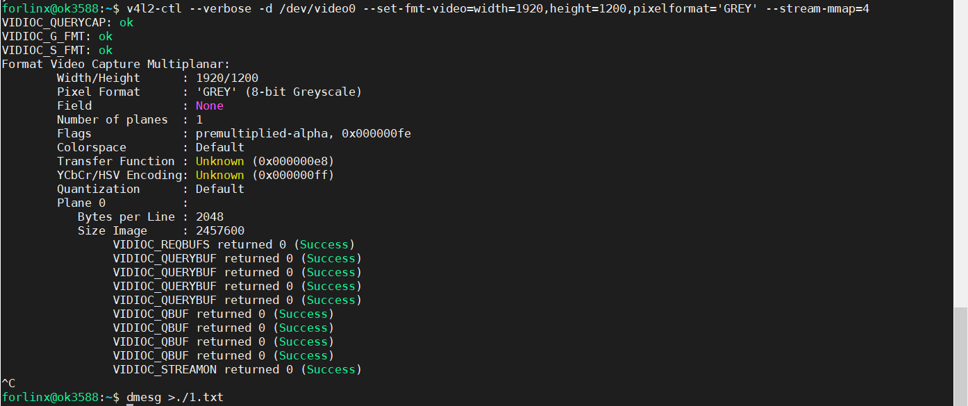

          @veye_xumm请问,你们调试的时候有遇到这种情况吗?没有数据流输出,一直阻塞 16a1f873-dc28-49a3-9b52-47e9ce0a76fb-image.png
            @lin 你是否用的是外触发模式?
            查看一下dmesg是否有报错?
            确认一下dts中关于mipi接口配置是否正确。

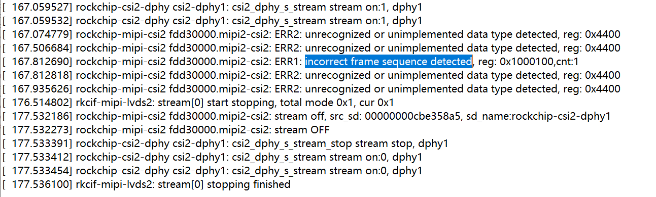

              lin @veye_xumm last edited by
              内核打印信息:1.txt
              还有您说的mipi接口配置是指链路设置还是mipi_csi2节点设置?

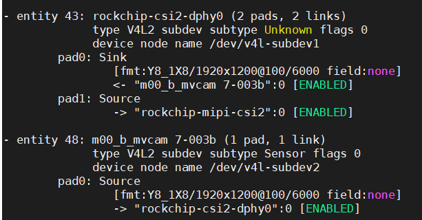

                  @veye_xumm 设备树OK3588-C-Camera.txt 拓扑图已经生成了拓扑图.txt ,哪里可能会导致阻塞呀?
                    @lin

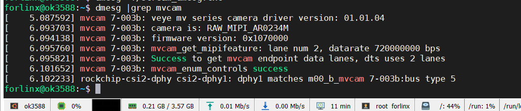

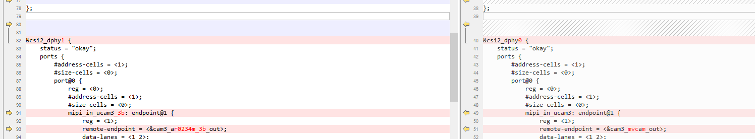

                    看你的拓扑图:
                    - entity 48: m00_b_mvcam 7-003b (1 pad, 1 link)
                                 type V4L2 subdev subtype Sensor flags 0
                                 device node name /dev/v4l-subdev2
                            pad0: Source
                                    [fmt:Y8_1X8/1920x1200@100/6000 field:none]
                                    -> "rockchip-csi2-dphy1":0 [ENABLED]
                    你这边设定i2c-7接口配套的mipi硬件接口是:csi2-dphy1
                    真的是这样的吗?
                    我给你的我们调过的那个dts,用的可是csi2-dphy0啊!
                      i2c-7接口配套的mipi硬件接口
                      我将接口节点换成csi2-dphy0也还是无法采集到图像数据

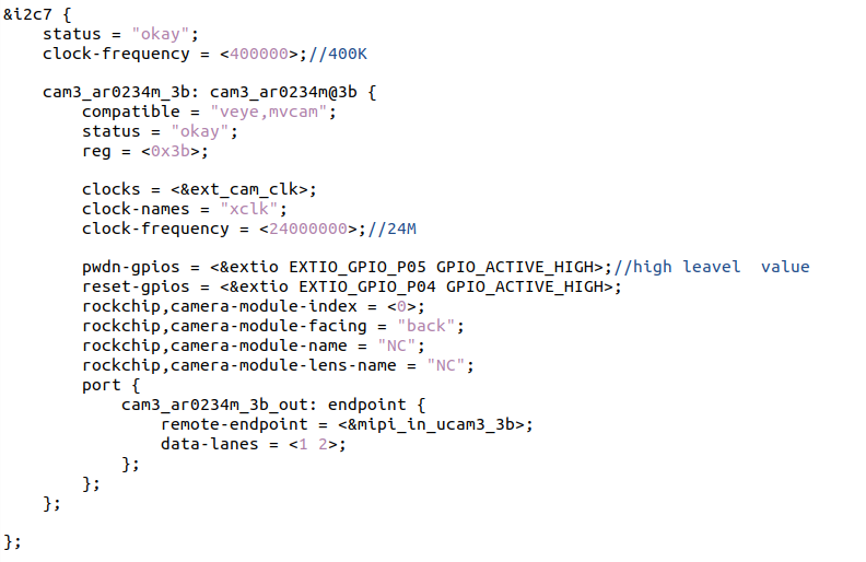

                              OK3588-C这个开发板,我之前贴的这个dts是调试过的。
                              没有要求,相机自己有时钟。
                              你直接用这个dts,然后配合我们官方发布的驱动。
                              在加上这个链接提示的问题点:https://wiki.veye.cc/index.php/FAQ_on_RK35xx_Platform/zh
                              应该可以直接调通i2c-7这一路才对。
                                我已经全部按照您说的进行了修改,但是相机还是无法出图,内核打印信息2.txt ,efedde5a-872d-4ed1-92b8-39639606c76e-image.png

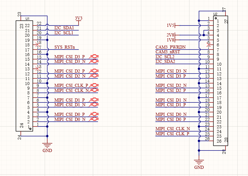

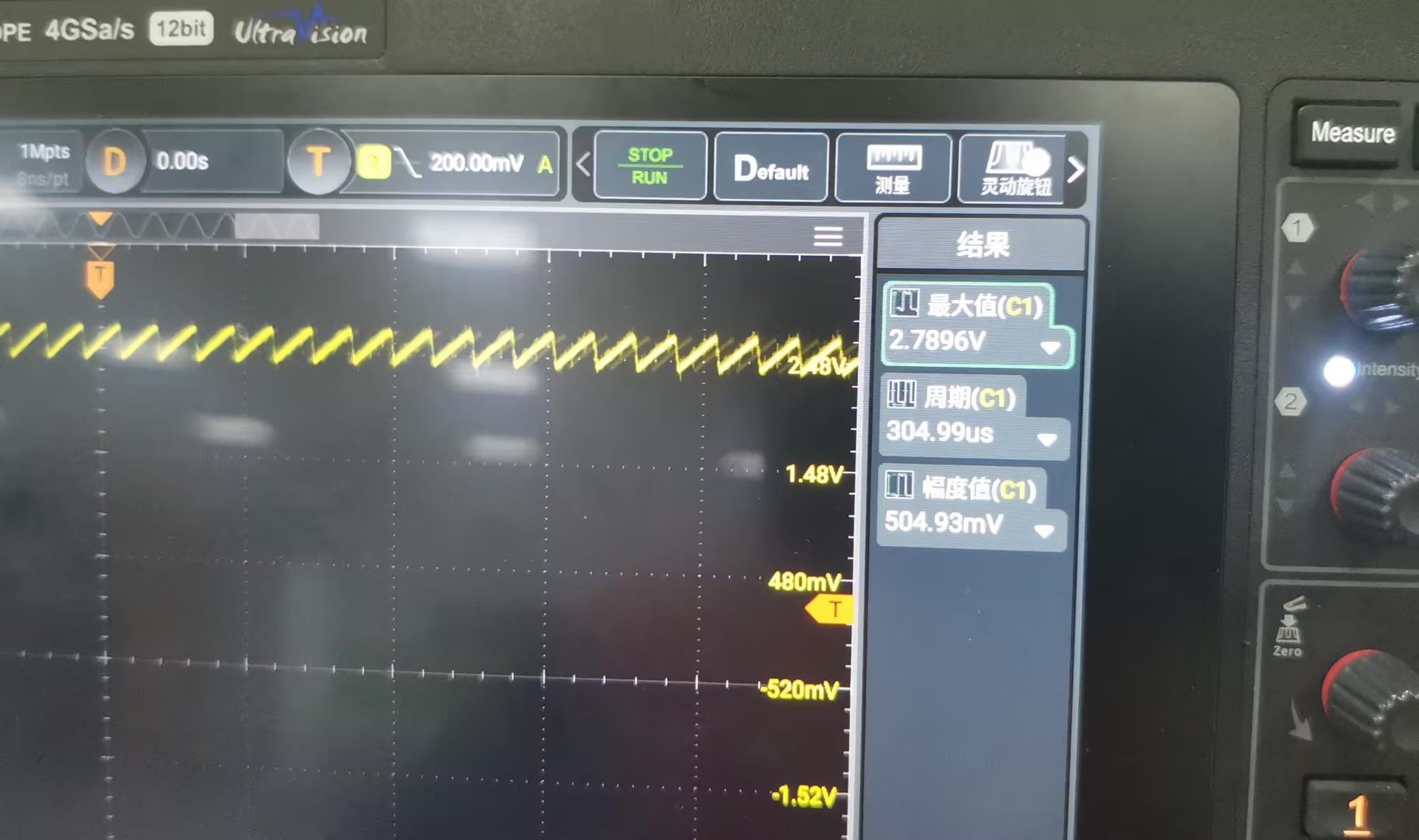

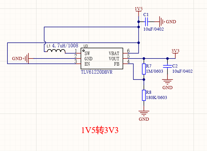

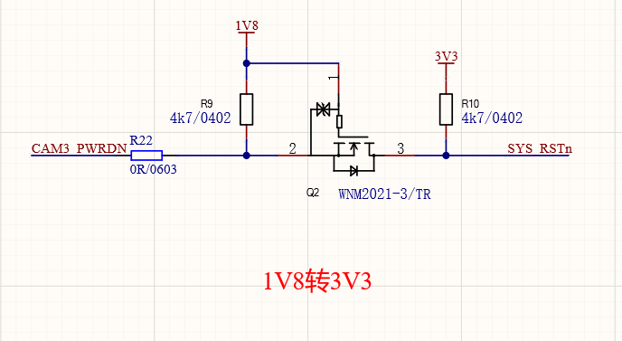

                                        自己画的转接板
                                        26fdf465-6f53-4c10-b657-37a1009dabae-企业微信截图_17182586821759.png [图片]
                                        9bfba84a-8616-444b-af02-36a3c1e01214-企业微信截图_17182586949890.png [图片]
                                        de4890d5-2c10-470c-b19c-fd7f09635cb1-企业微信截图_17182587081125.png [图片]
                                          @lin
                                          确认下这个3.3V是否稳定输出(幅值>3.2V)。100mA@1.2V(或1.5V)看起来功率是不够用的。

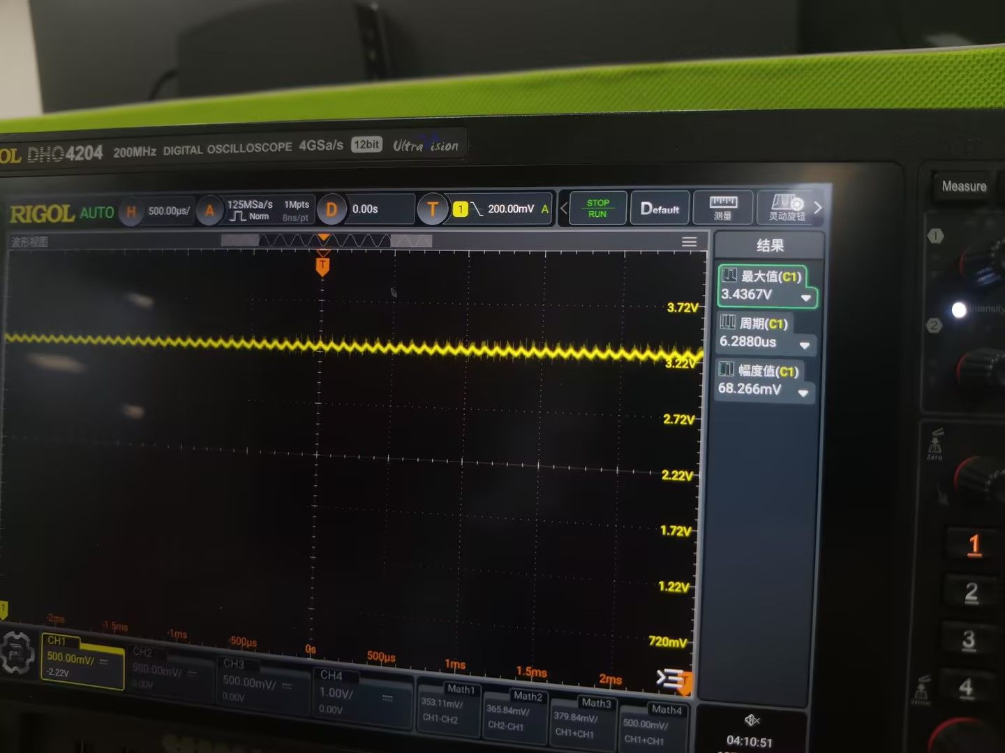

                                            @veye_xumm电源测量结果: ec3401ed-fcd4-4c47-971f-7c29209314bc-676c3e3dd647716c5d7ea20b62b5caf1.jpg [图片]
                                            功率不够需要怎么解决,外加电源吗?功率需达到多少可以呢?
