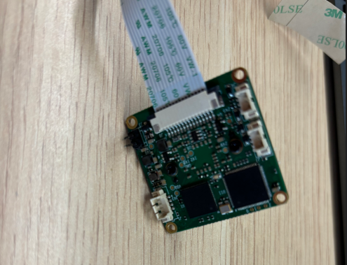

            F 1 Reply Last reply Reply Quote 0
              fancong @veye_xumm last edited by
              @veye_xumm ![替代文字](screenshot-20240319-105841.png screenshot-20240319-105828.png 图片地址)
                veye_xumm @fancong last edited by
                @fancong 看起来树莓派那头插反了
                F 2 Replies Last reply Reply Quote 0
