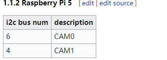

                                          No. Just pay attention to i2c bus number.

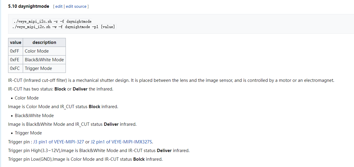

                                            @veye_xumm This is not clear to me. For example, how can I switch Infrared filter on/off then? It seems to me the veye_mipi_i2c.sh script is not working at all.
