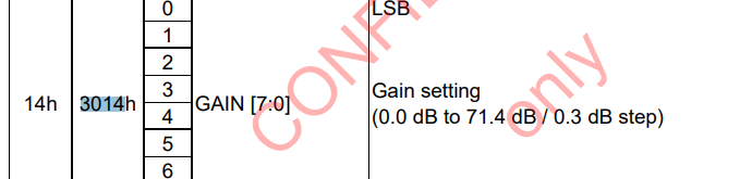

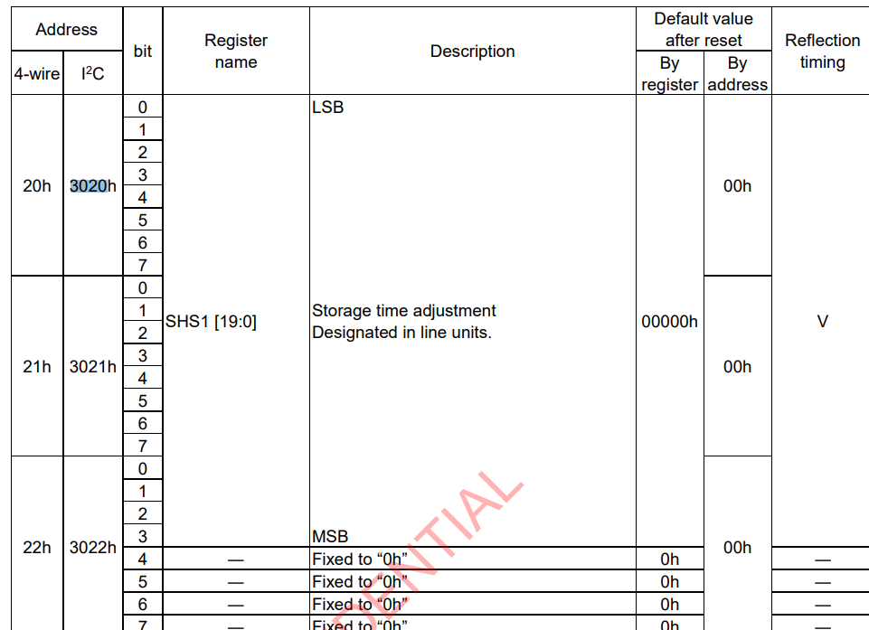

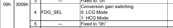

                              @milank
                              I have provided a script in the attachment which can read the sensor registers.
                              Can you please add a monitoring program in your system to monitor the following registers of the sensor: 0x14, 0x20, 0x21, 0x22, and 0x09.
                              The usage of the script is: ./veye_inner.sh -r -f sns_reg -p1 [sns_reg_addr].
                              Especially pay attention to whether the registers of the sensor have changed when a sudden change in brightness is detected.
                              veye_inner.sh.txt
                                milank @veye_xumm last edited by
                                fine, understood, now it is running in the background for spoken registers.
                                I will come back with the results once I see the spike again.

                                  Another change has been detected last night, around 20:44:25 UTC.
                                  Unfortunatelly, no change detected in spoken registers.
                                  The reading interval was set to 5 seconds.
