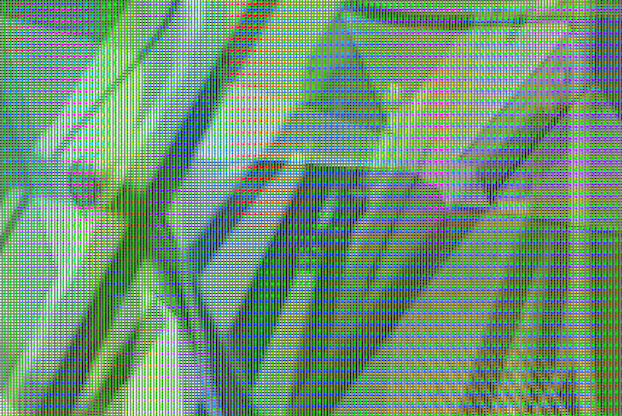

            Hello, I am very close to get the V4L2 API to work. After capture the frame and display with opencv I got a video like thisScreen Shot 2022-06-30 at 11.37.53 AM.png
            It looks like I am having a pixel alignment issue and I hope you could have some suggestion. Here is the portion of the C++ code that I used to convert into OpenCV Mat:
            static void process_image(const void *p, int size)
            int width=VCOS_ALIGN_UP(1920, 32);
            int height=VCOS_ALIGN_UP(1080, 16);
            Mat image = Mat((int)(height * 3/2), width, CV_8U, (uint8_t *)p, width);
            cvtColor(image, image, COLOR_YUV2BGR_I420);
            imshow("T6 Display", image);
            waitKey(1);
              veye_xumm @thn last edited by
              @thn
              Are you using the V4L2 drive mode?
              The data format you get directly from /dev/video0 should not be YUV420. I think it's in UYVY format, which means one pixel has two bytes.
              You can get it by
              v4l2-ctl --list-formats-ext
              T 3 Replies Last reply Reply Quote 0

                    Hi again, finally I figured out how to convert the V4L2 frame buffer into OpenCV BGR Mat. Here is an example code in case anyone want to know. I uses COLOR_YUV2BGR_YUYV because I already used the i2c command to set the camera to YUYV.
                    The problem with this code is that the function cvtColor is very CPU intensive and it will bring the frame rate down to about 20 FPS. I hope there is a better way to use this camera in the Pi OS 64 bit mode.
                    Mat yuv = Mat(height, width, CV_8UC2, (uint8_t *)p, width);
                    cvtColor(yuv, yuv, COLOR_YUV2BGR_YUYV);
                    imshow("Display", yuv);
                    waitKey(1);

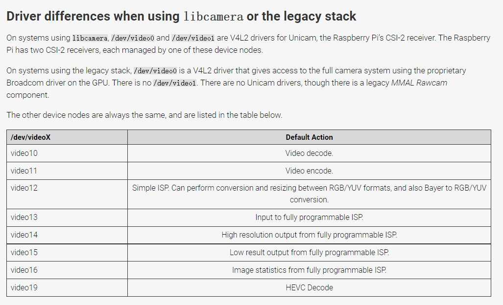

                          I would like to outline my thoughts here.
                          In the last few days I took a brief look at the code of libcamera and libcamera-apps.
                          They use the very new Morden C++ (C++17 I think), which causes me to read very slowly. C++ has changed so much over the years that I almost don't recognize it anymore.
                          I don't guarantee that what I say is completely correct.
                          This diagram below is from the official Raspberry Pi documentation. It is the basis for our discussion.
                          The Raspberry Pi encapsulates the image processing functions of ipa and gpu to the linux driver level and provides application layer calls in the form of video node.
                          libcamera stack
                          This is the pipeline of libcamera :
                          sensor's bayer raw data  from video0 ---> video13-----> [ISP functions]--->video14----->YUV420------> apps
                          libcamera do not call video14 directly, It use Streams provided by libcamera.
                          The solution to use VEYE camera with libcamera I foresee
                          NO.1
                          Give up libcamera, because libcamera is essentially for isp service, VEYE camera has built-in isp function, so there is no need to use libcamera at all.
                          From /dev/video0 we can get the output data of camera directly, which is UYVY format.
                          UYVY format is very difficult to use, h.264 and preview components prefer yuv420. So video12 comes in handy.
                          VEYE UYVY data  from video0 ---> video12--->YUV420----->apps
                          video12 uses gpu resources for format conversion, which is my recommended usage.
                          NO.2
                          NO.1 is a straightforward solution, but it actually removes libcamera-apps as an off-the-shelf package, unfortunately.
                          Another hacking solution is to create a pipeline that uses video12, inside libcamera.
                          Or, modify the existing pipeline to support UYVY mode input.
                          It seems to me that the Raspberry Pi organization has effectively refused to do so.
                          Of course, the above discussion is all theoretical and a long way from code.

                            So should I access /dev/video12 in my v4l2 app and request YUV 4:2:0 or even BGR3? Will your current driver support that?
                            Thanks,
                              @thn I think video12 is just a converter, you can't access it directly to try to get camera data.
                              The correct way to do this is to access video0 and get the camera data, then input this data to video12 and then read the YUV420 from video12.
                              T 1 Reply Last reply Reply Quote 0
