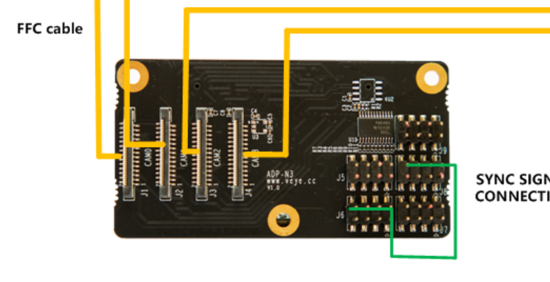

      g-towboat last edited by
      I have an CS-FPD-XAVIER-nCAM-IMX307 with 8 camera system - it works perfect!
      Now I want install the sync mode. In your manual its described as:
      SYNC signal connection:
      The synchronization signal is connected as shown in the figure above. J5 needs to be connected with J7's 2, 4, 6 and 8pin, and J6 is connected with J8's 2, 4, 6 and 8pin.
      For the schematic diagram of the SYNC signal, please refer to:
      ·          FPD-LINK3-2RX Datasheet
      ·          ADP-N2 Datasheet
      ·          ADP-N3 Datasheet
      But i dont know exactly what to do.
      Can you describe it an in other way. Or do you have an photo of the wiring on the APD-N3 Board?

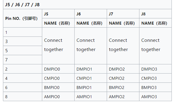

        veye_xumm @g-towboat last edited by veye_xumm
        @g-towboat
        Accroding to the version log,http://wiki.veye.cc/index.php/CS-MIPI-IMX307_version_log,
        CS-MIPI-IMX307_FV2.33_LV3.3_20201106.bin
        Optimize the sync mechanism by using only frame synchronization signals.
        Fpdlink mode synchronization is supported.
        So the J5 to J8 connection is not necessary anymore. You just need to connect J6 and J8 together, as shown below.
        Please notice the pin1、3、5、7 of J6 and J8 are connected together separately, please use them flexibly.
        http://wiki.veye.cc/index.php/ADP-N3_Data_Sheet_index

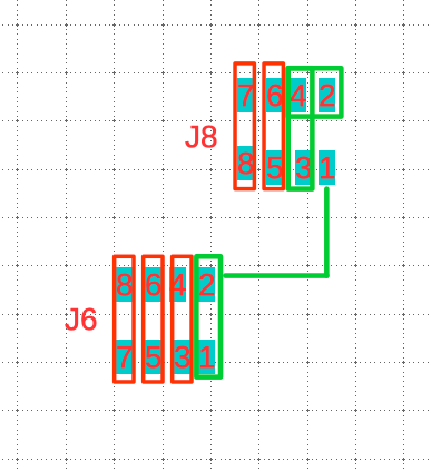

                @g-towboat
                It's not some pairs of connection. It's a group of connection.
                For example:
                J6-2 is the source of XVS, and J6-4 J6-6 J6-8 J8-2 J8-4 J8-6 J8-8 are all sink of XVS.
                So what you need to do is connect all these pins together.
                J6-1 J6-3 J6-5 J6-7 are already connected together on the board.
                J8-1 J8-3 J8-5 J8-7 are already connected together on the board.
                You can use them if you want.
                G 2 Replies Last reply Reply Quote 0

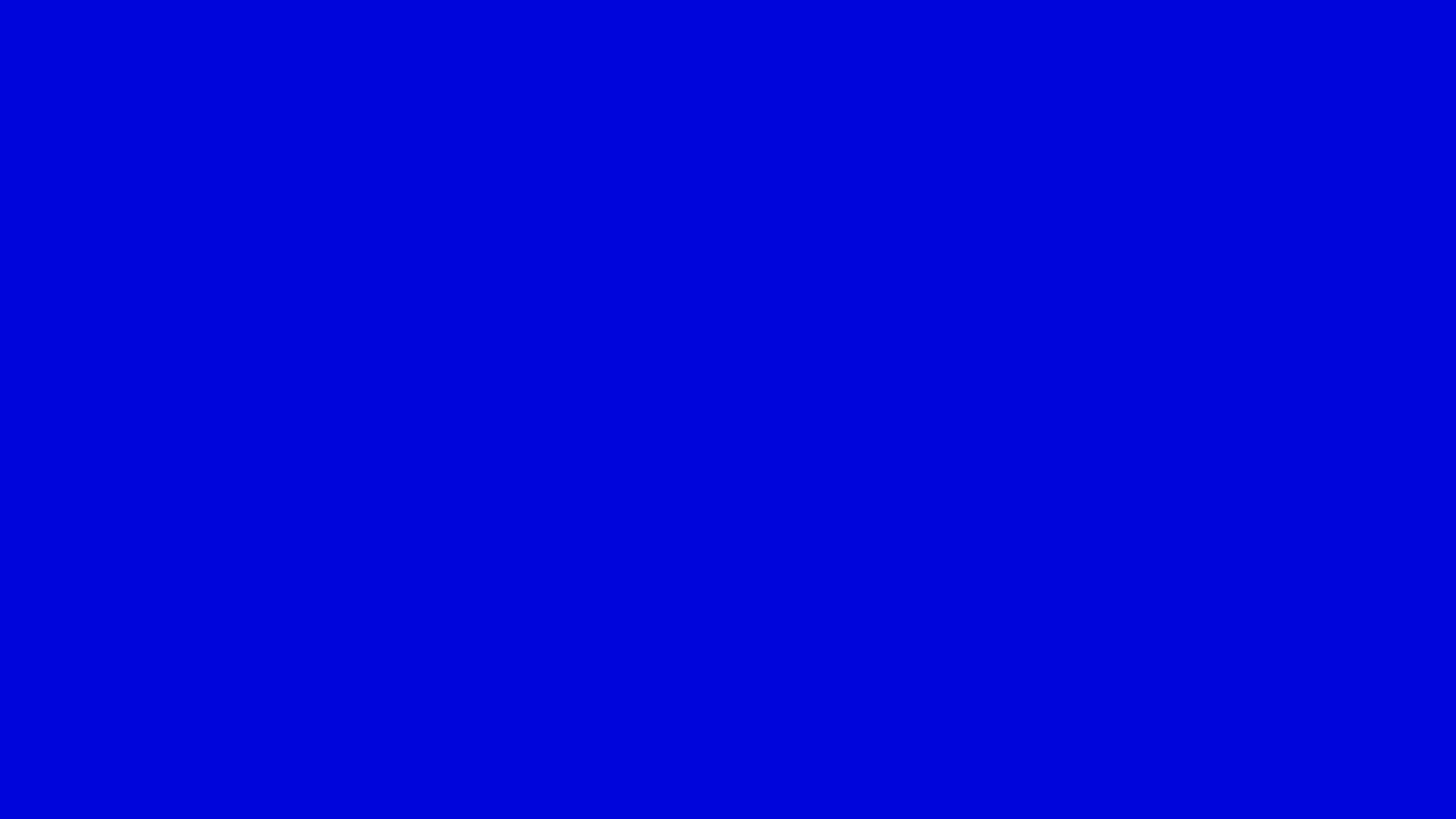

                • G
                  g-towboat @veye_xumm last edited by
                  • G
                    e.g my post here:
                    http://forum.veye.cc/topic/21/camera-i2c-configuaration-for-sync-mode
                    I just have blue images like the post here:
                    http://forum.veye.cc/topic/22/i-want-to-synchronize-the-two-cameras-in-sync-mode
                    But i have 8 cameras connected.
                    Do I also connect the boards: FPD-LINK3-2RX?
                    or is it the i2c configuration?
                    veye_xumm 2 Replies Last reply Reply Quote 1

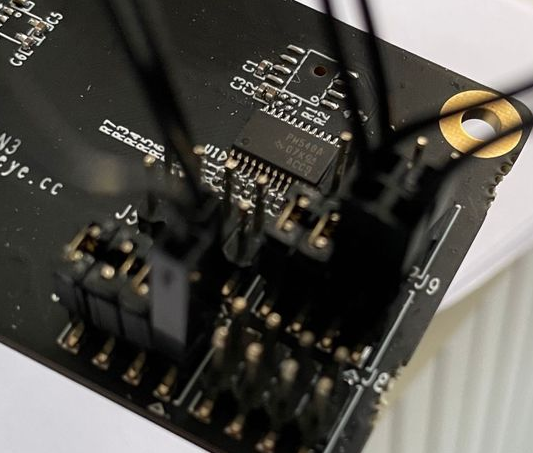

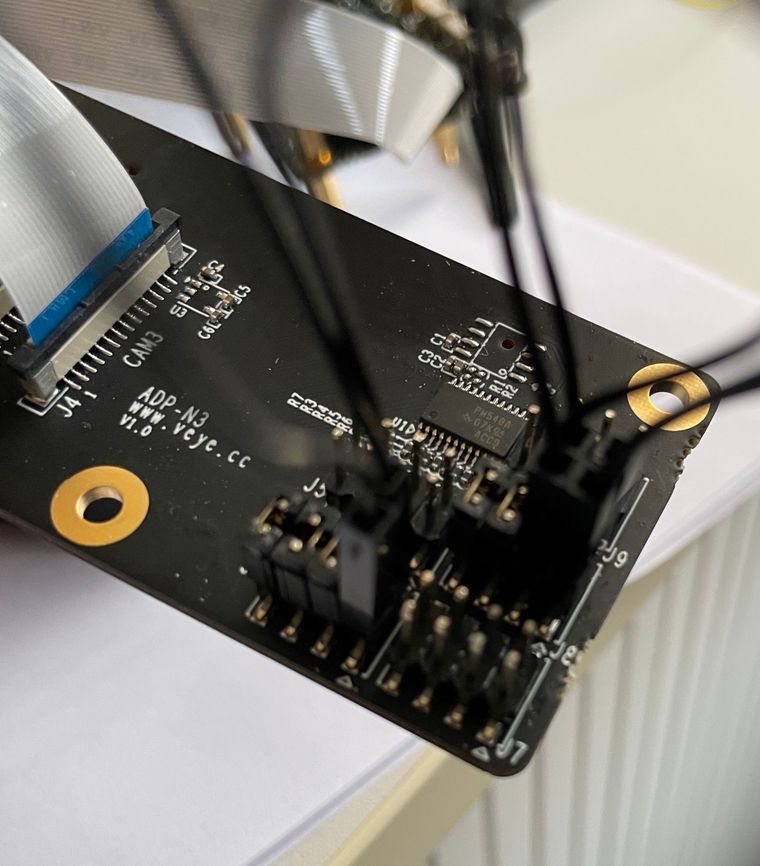

                            • G
                              @veye_xumm I still have blue Images.
                              Wire configuration standard.
                              Changed as reference in http://forum.veye.cc/topic/22/i-want-to-synchronize-the-two-cameras-in-sync-mode/6?_=1616485571342
                              Can you please check what i am doing wrong or post a detailed photo of the right configuration.
                              Thank you
                                @g-towboat
                                I think you pick out the wrong wire.
                                G 1 Reply Last reply Reply Quote 0
