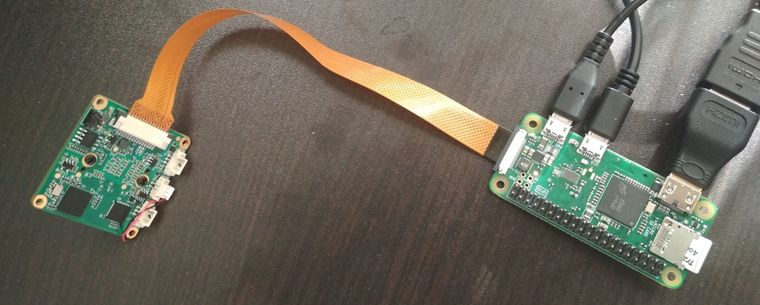

      Hello.
      The camera worked well, but after the next turn on the image disappeared.
      Could a firmware update help?
        veye_xumm @Dan_LionKing last edited by
        @dan_lionking
        Since your i2c cmd can not read any correct value now, I think you'd better check the hardware connection first. FFC cable direction,for example.
        You can also post an image of your camera and RPI connection details. I will check it for you.

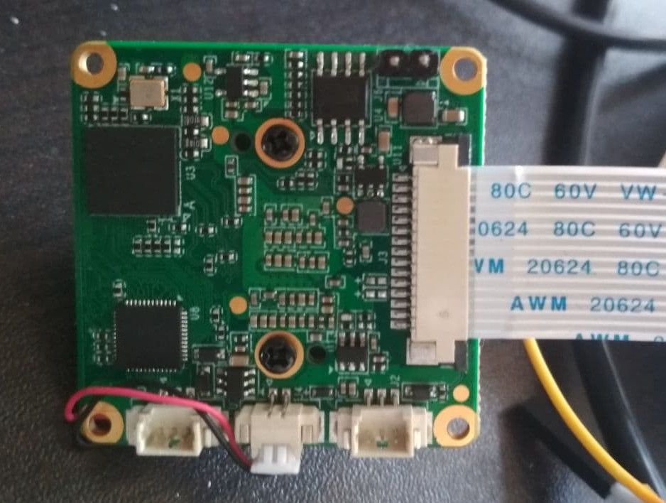

          Dan_LionKing @veye_xumm last edited by
          Raspberry Pi Zero, FFC cable from camera set.
            veye_xumm @Dan_LionKing last edited by veye_xumm
            @dan_lionking
            I think your connection is correct. Do you have a multimeter? Can you check the power on FFC?

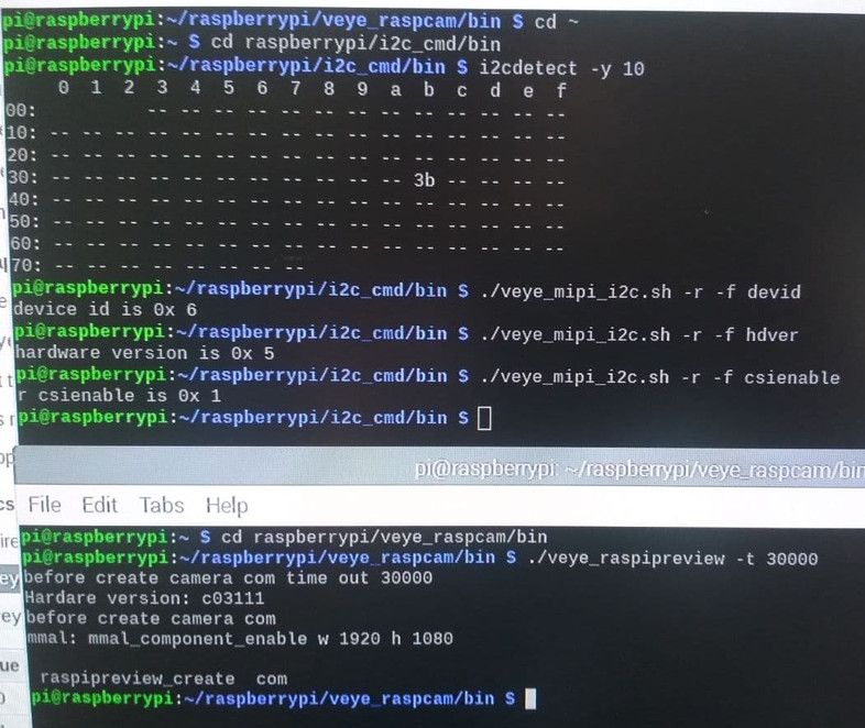

            pls try
            i2cdetect -y 10
              power on FFC 3.27 V
                @dan_lionking
                It's very strange to show that you can detect to the camera, but in your post a few days ago, you can't read the register.

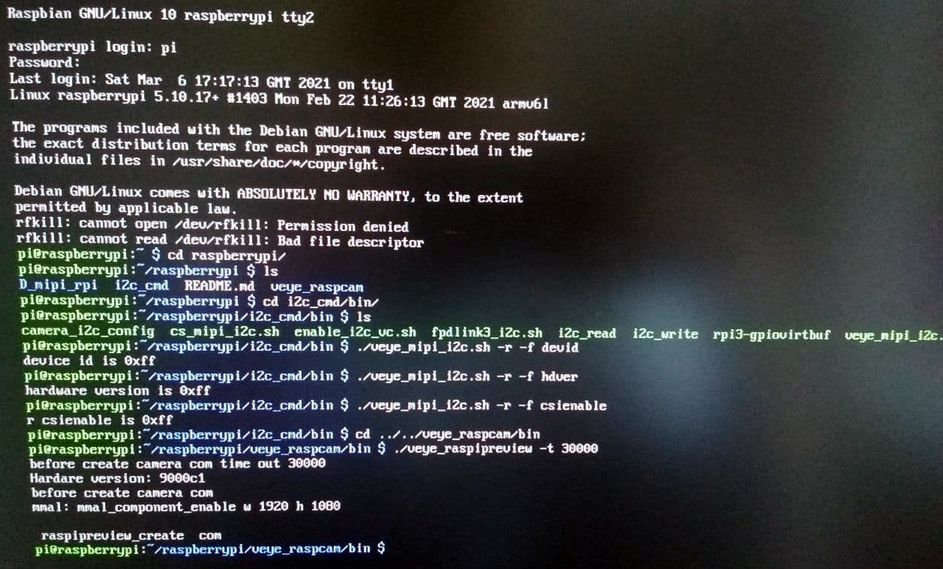

                  @veye_xumm firmware update?
                    @dan_lionking
                    I think the information you provided is contradictory. Could you please repeat test:
                    i2cdetect -y 10
                    and
                    ./veye_mipi_i2c.sh -r -f devid
                      no image from camera
                        @dan_lionking
                        So this camera's i2c is OK.

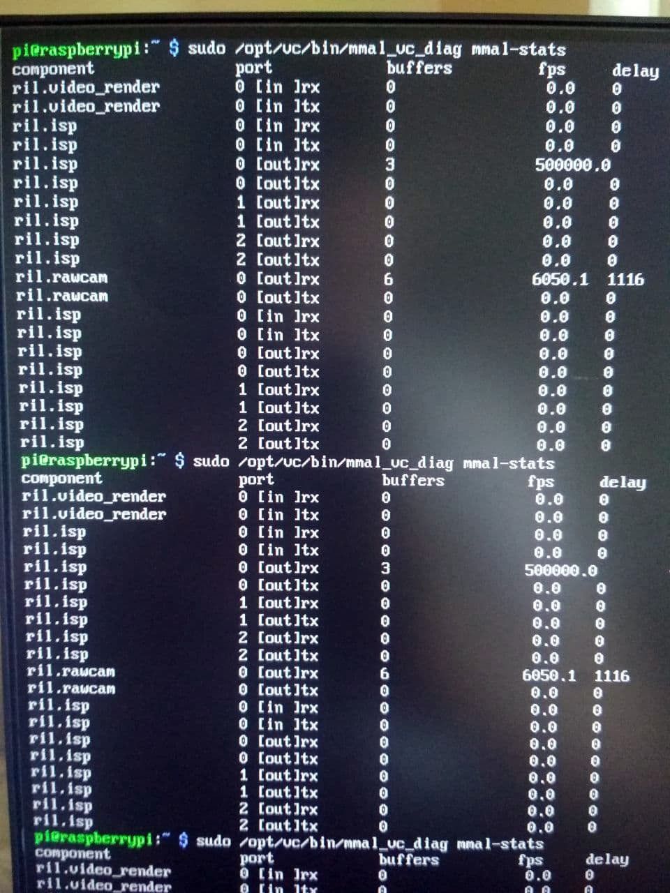

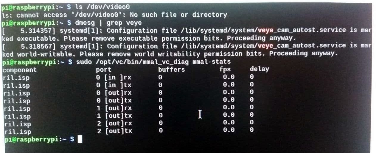

                        1. Have you tried V4L2 mode? Maybe forgot to uninstall driver?
                        2. pls try running this cmd in another terminal while veye_raspipreview is running.
                        sudo /opt/vc/bin/mmal_vc_diag mmal-stats
                            @dan_lionking

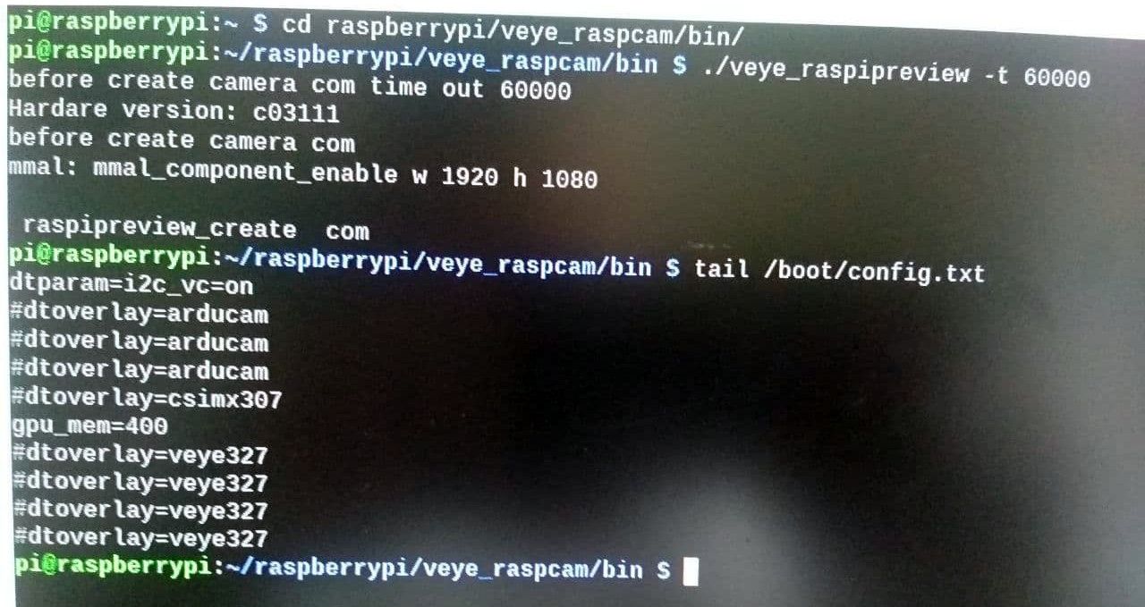

                            I'm sorry it took a long time to troubleshoot the problem.
                            Considering the current situation, I think it is possible that some of the circuits of the camera have been burnt out for some reason.
                            But there are three more points I need you to confirm.
                            1. Please help me to run this order.
                            tail /boot/config.txt
                            1. Is the mmal-stats cmd result you posted was running while veye_raspipreview running?
                            2. Please take a close picture of the circuit near the camera FFC cable. I need to check that if some of the protective devices have been burnt out.
                                This mmal-stats cmd result was running while veye_raspipreview running.
                                Yes, I have other VEYE-MIPI-IMX327S. They work well on the same board Rapspberry.
                                      @dan_lionking
                                      Would you please check whether these two components are damaged? These two are protective devices. I have encountered customers plugging in 5V power supply upside down, resulting in burnout.
                                      If it burns out, you can try to remove these two components .
                                        The components appear to be functional. For a detailed check, inform the component type and pinout.
                                          @dan_lionking
                                          I have encountered problems like yours. The camera is not damaged and the FFC Cable contact is not good. You can try to replace a FFC cable.
                                          But it's also possible that the camera did break down for some reason. You can try to remove these two devices with an electric soldering iron. These two are protective devices, and removal will not affect the function.
